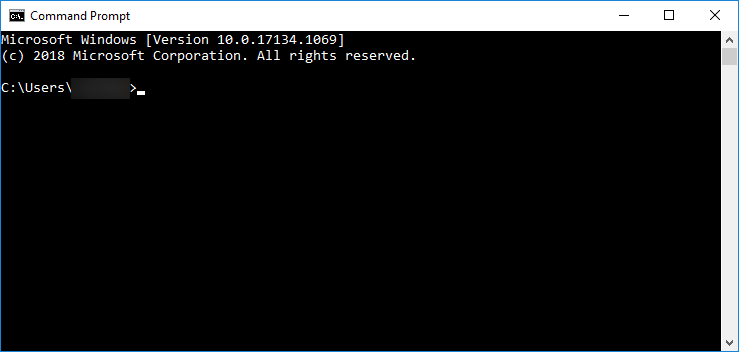

  1. Launch the Command Prompt on Windows or Terminal on Linux.
    The Command Prompt opens as seen in Figure 1.
