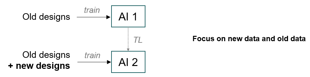

When should I use transfer learning?
- Repurpose a PhysicsAI Model
- Adapt a generic model for a new class of designs.
- Update an Existing PhysicsAI Model
- Use the old model and new data to create an improved model.
