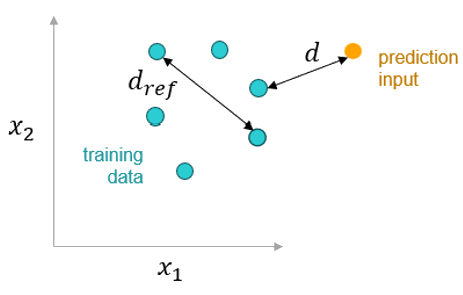

Like all machine learning models, PhysicsAI models are most accurate when the design being predicted is similar to the designs used for training.
Figure 1. Visual Representation of Similarity Score
Similarity score:
1 − d d r e f MathType@MTEF@5@5@+= feaahGart1ev3aaatCvAUfeBSjuyZL2yd9gzLbvyNv2CaerbuLwBLn hiov2DGi1BTfMBaeXatLxBI9gBaerbd9wDYLwzYbItLDharqqtubsr 4rNCHbGeaGqiVu0Je9sqqrpepC0xbbL8F4rqqrFfpeea0xe9Lq=Jc9 vqaqpepm0xbba9pwe9Q8fs0=yqaqpepae9pg0FirpepeKkFr0xfr=x fr=xb9adbaqaaeGaciGaaiaabeqaamaabaabaaGcbaGaaGymaiabgk HiTmaalaaabaGaamizaaqaaiaadsgadaWgaaWcbaGaamOCaiaadwga caWGMbaabeaaaaaaaa@3C79@
1.0
Equivalent to training sample
0.0
As far from the nearest training point as any two training points are from each other
< 0.0
Far from a training point
Proceed with caution

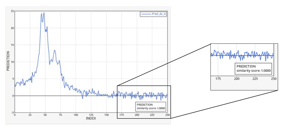

Figure 2. Similarity Score for Curves
When you make a prediction, PhysicsAI will quantify how similar the input design is to the training data in the form of a similarity score. In HyperMesh, the similarity score is displayed in the top-right corner of the prediction window.

Interpret Similarity Scores
A similarity score of 1.0 indicates that the input design is the same as one of the training points. This is the maximum possible value.
A similarity score of 0.0 indicates that the input design is as different from the nearest training point as the two farthest training points.
A negative similarity score indicates that the input design is very different from the training data. It’s likely that the prediction will be low-quality unless a new model is trained with data sufficiently similar to the predicted designs.
Note: Datasets with very little geometric variation, especially when shape changes are the same magnitude as mesh discretization variances, may result in abnormally low negative similarity scores.
