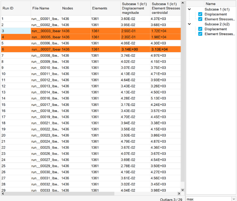

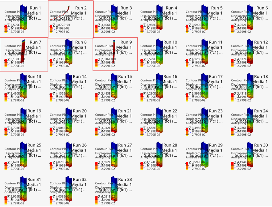

Curation
Inclusion of outliers can introduce noise and depreciate the prediction accuracy. Hence, the available training data needs to be carefully curated by excluding the outliers. This is a manual process but tools available within HyperMesh (dataset outlier detection) and HyperStudy (parallel plots, 3D visualization, KPI tracking) can be used. Outliers can be identified using multiple criteria. These include but are not limited to:
  • Inconsistent number or type of parts
  • Inconsistent and/or unequal number of timesteps
  • Rotational and/or translational variance (before version 2025.0) in the orientation of parts
  • Outlying KPI values
Figure 1. Outlier Detection Using HyperStudy
Figure 2. PhysicsAI Dataset Creation Tool

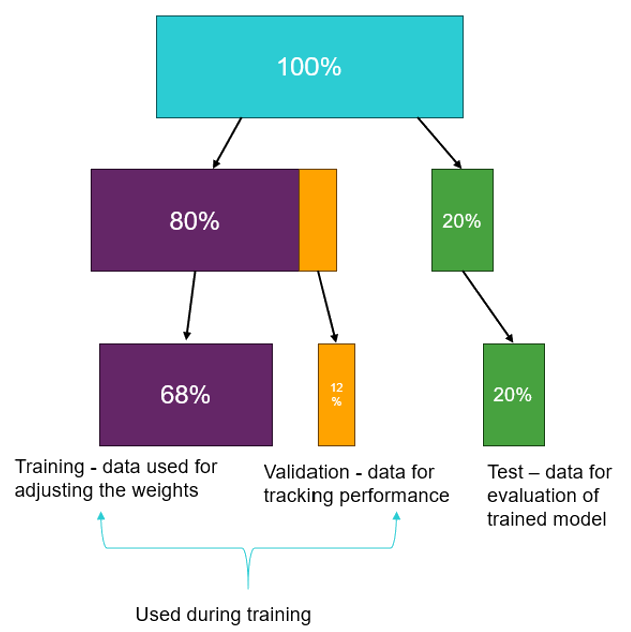

Partitioning
Typically, the filtered-out training data is partitioned into train, validation, and test datasets. PhysicsAI automatically does this partitioning using the following rules:
  • The entire dataset is split into train and test sets based on the fraction input (default is 0.80- 80% for training and 20% for testing).
  • The train set from the previous step is further split into train and validate sets (fixed value of 0.85 – 85% for training and 15% for validation). A validation set is only created if the training set is more than 13, otherwise only the training dataset is used.
Figure 3. Partitioning of Available Data
The role of a validation dataset is to avoid overfitting; the network is adjusted for the training data but the loss is tracked for the validation dataset. This ensures that the model can predict well for most data points in the design space and not just the training data points. If the original dataset is small, the validation dataset can be too small (<5) which can result in it being an incomplete representation of the design space. As such, more data is needed for certain problems to get a sufficiently large validation dataset for a better performing model.

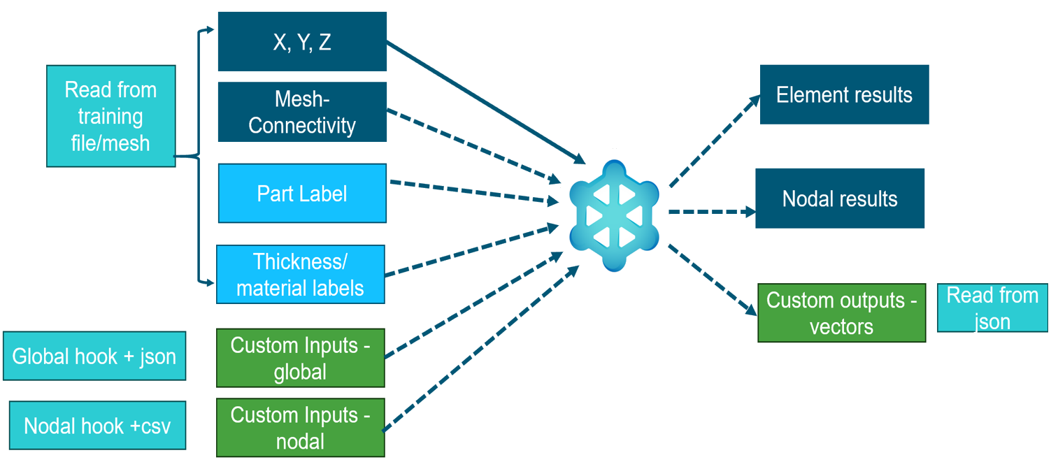

PhysicsAI supports the following inputs and outputs for training the models.
Figure 4. Inputs and Outputs to a PhysicsAI Model
Inputs
Nodal coordinated (default and always selected)
Part labels (default but unselected): to distinguish between rigids/non-rigids or different materials.
Thickness and material labels (using Extract Simulation Properties): enabled if supported solver decks are present. For a list of supported solver decks, refer to Frequently Asked Questions.
Global inputs (custom input - optional): input using a .json file and read using a python hook. These are applied to each node and hence are global. Typically used to input a global property such as material characteristics, global boundary conditions, and so on.
Nodal inputs (custom input - optional): input using a .csv file and read using a python hook. These are applied to specific nodes. Typically used to input node varying properties such as nodal loads and other boundary conditions.
Outputs
Contour/field results (optional): identified by load case and result label. Directly imported from the training simulation files.
Vector results (custom output – optional): used for curves or KPIs and identified using a text label. Input using .json files. The vectors are plotted against indices. Hence, the onus is on you to ensure that the vector lengths and timesteps are consistent.
Generation of the auxiliary files for custom inputs and outputs (.json and .csv files) is typically done outside PhysicsAI using scripting or other tools such as HyperStudy or Compose. The onus is on you to generate these files.

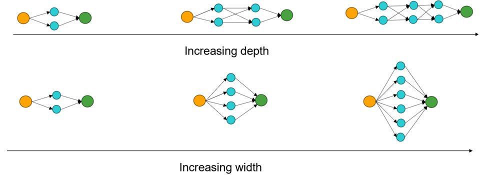

  • Width: controls the width (number of neurons in starting layer). Higher widths result in better resolution (capturing the finer details in the model) but also increases the memory requirements. The typical range of width values is 10-300 for GCNS and 48-256 for TNS.
  • Depth: controls how deep the neural network is (number of layers). Higher depth results in increased complexity of the model (analogous to order of polynomial). Typical range of width values is 1-10 for GCNS and 4-10 for TNS.
    Figure 5. Effect of Increasing Width and Depth on the Underlying Neural Network Architecture

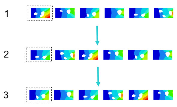

  • Epochs: an epoch involves training on each data point once. Thus, the number of epochs specifies the number of training iterations. Complex problems need longer epochs. If you are unsure about how many epochs are needed, a large value (>5000 epochs) could be selected with early stopping enabled.
    Figure 6. Sequential Training During Epochs
    Early stopping checks if there is no improvement after the specified number of epochs (patience) before terminating the training. PhysicsAI uses the best epoch (lowest validation loss or, if not available, the training loss) and not the last epoch as the final configuration of the model.

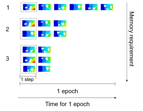

  • Batch size: determines how many data points are seen at once. Larger batch sizes lead to faster training but might negatively affect accuracy. The batch size should be tuned for each problem. The batch size defaults to 1.
    Figure 7. Effect of Batch Size on Memory Requirements and Time Per Epoch
    Within an epoch, batches of data are passed to the learning model in a series of steps. Each single piece of data will be in only one step during each epoch. In each epoch, the data is randomly shuffled into steps. Figure 8 illustrates a training with six data points (A-F) to compare the effect of batch size. When the batch size is two, each epoch contains three steps and requires six overall steps in the two epochs. In contrast, when the batch size is three, each epoch contains two steps and requires four overall steps in the two epochs. Using a batch size of three requires less overall steps, but at the expense of larger memory requirement to load the batch into memory. The optimal batch size depends on the problem being solved and can truly be determined through trial and error.
    Figure 8. Progression of Training Inside Each Epoch

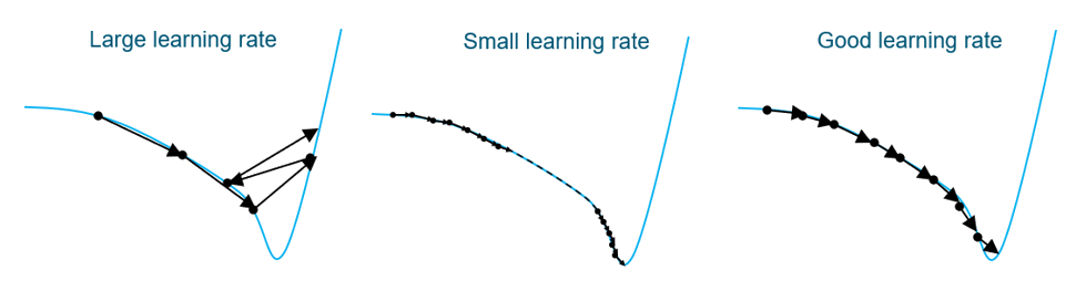

  • Learning rate: determines the step size by which the parameters are adjusted during each step of every epoch. Adaptive learning rates are more robust than constant ones. Adaptive learning rate follows the cosine decay law where you specify the final fraction that the learning rate reduces to. Typically, the last parameter that should be modified as the default value should be sufficient for most problems.
    Figure 9. Effect of Varying Learning Rates
    The optimum learning rate is large enough to quickly move closer to the optimum but small enough to not skip the optimum value.

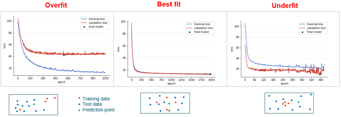

PhysicsAI outputs both a text log and a graphical representation of the loss values during training. Note that the loss is measured as the Mean Square Error (MSE) in transformed units. It is difficult to know what a good MSE value is or how well the model has trained by purely looking at the loss curve. However, overfitting, underfitting, or noisy models can be identified.
Figure 10. Different Types of Loss Curves
  • If the validation loss is much higher than the training loss, then the model is overfit to the training data. This implies that the model is not generic enough for the design space. This could possibly be due to a small or skewed dataset.
  • An optimally trained model will have both the training and validation losses converge closer to each other.
  • If the validation loss is lower than the training loss, then the model is possibly underfit or the validation set is not diverse enough to represent the design space.

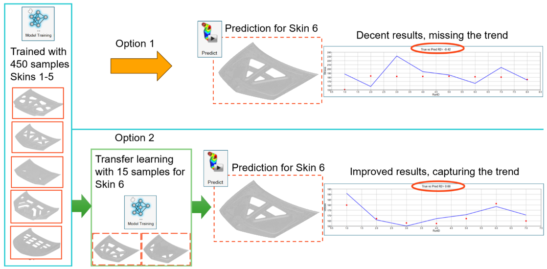

Transfer learning means learning from a previous trained model. It essentially uses the reference model as the starting point for the training instead of a random configuration. This is useful for adapting a model to the current dataset. Thus, it is important to ensure that the available model is relevant for the current dataset. Additionally, the inputs need to be consistent.
Figure 11. Example of Transfer Learning Where a Generic Model is Adapted for a New Dataset
Transfer learning should be used to:
Repurpose a PhysicsAI Model
Adapt a generic model for a new class of designs.
Figure 12. Valid Uses of Transfer Learning
Update an Existing PhysicsAI Model
Use the old model and new data to create an improved model.
Figure 13. Valid Uses of Transfer Learning Continued
