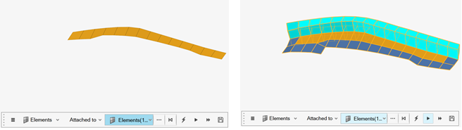

Attached To Function
The Attached to function finds entities that are attached or connected to the selected FE entities.
For example, finding elements that are attached to the selected elements.
- Display
the next layer of connected entities.
- Find
all entities connected to the selected entities. This is equivalent to clicking
repeatedly on
till
there are no more entities that are connected to the selected entities.

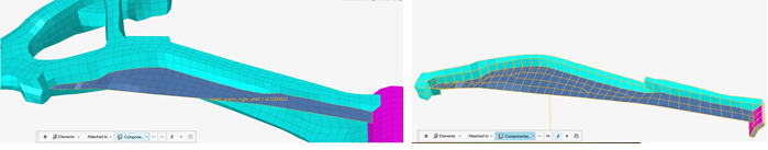

The Attached to function can also be used to find entities that are not the same as the input entity. For example, the image below shows components attached to the selected elements are found.

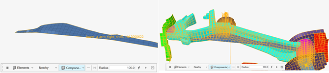

Nearby Function
The Nearby function finds entities that are near the selected entities, within a specified distance that can be modified in the Radius input field.
The default radius value is 100.
In the example shown in below, all the elements within a search radius of 100 of the selected elements are found.
