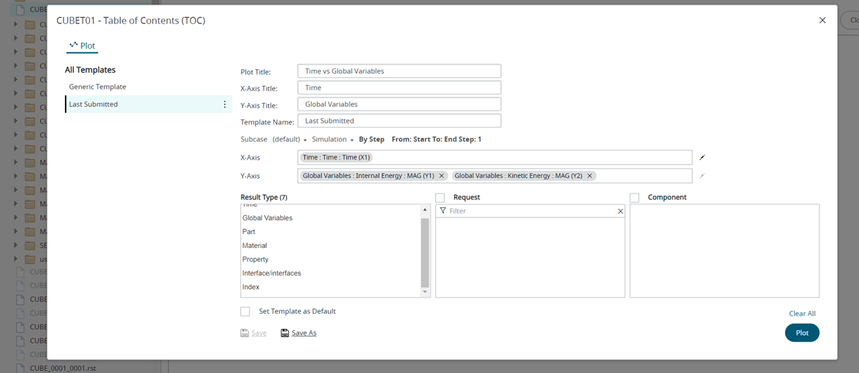

The plot Table of Contents (TOC) is displayed. - Optional: Enter a name for Plot Title.
- Optional: Enter a name for X-Axis Title.
- Optional: Enter a name for Y-Axis Title.
- Optional:
Enter a name for Template Name.
The first time you create a plot, the default values are displayed in the TOC. If you change any parameters, click Generic Template to reset their values.
- Optional:
Click Subcase and select the required load case.
Note: By default, the first entry in the subcase list is considered for a plot.
- Optional:
Click Simulation to select a simulation query.
Figure 2. Plot Simulation Query Menu
- Click OK.
For X-Axis parameters, to choose different parameters click
located to the right of the field.
Note: By default, the first entry in the result parameters list is considered for a plot. -
Select the required parameters for Y-Axis from the Result
Type, Request and
Component sections.
Figure 3. Select Plot Parameters
The selected components are added as X-axis and Y-axis variables.Tip: Click
to clear the Y-axis selections.
- Optional: Click Set Template as Default to set this template as a default template.
Click Plot.

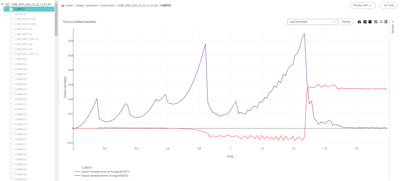

The plot result is displayed for the selected parameters. The Last Submitted template is updated with the selected parameters and is also displayed in the Template drop-down list as shown here:
Figure 4. Plot Result
Tip: Click
to return to the plot TOC to modify the
plot parameters.
