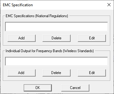

Both the EMF results and the EMC results are governed by the specifications provided in
the .emc file, which can be defined at Data > EMC Specification, see Figure 2.
Figure 2 is for both EMF (human
exposure) and EMC. It enables you to specify frequency-dependent exposure limits
according to multiple standards and multiple frequency bands. The exposure limit (for
electric field) is in V/m and the frequency is in MHz.
