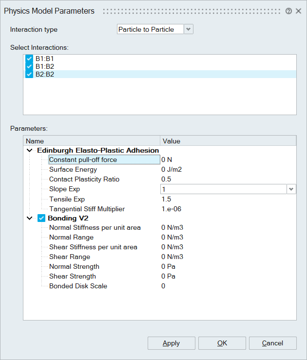

Physics Model Parameters
This tool used to select define the model parameters for different interactions based on the particles and material used in the current simulation.
Interaction Type: User can define model parameters for different interactions.
Following interactions supported
- Particle to Particle
- Particle to Geometry
- Fluid to Particle
Parameters:
- User can select the interaction pairs and define the model parameters.

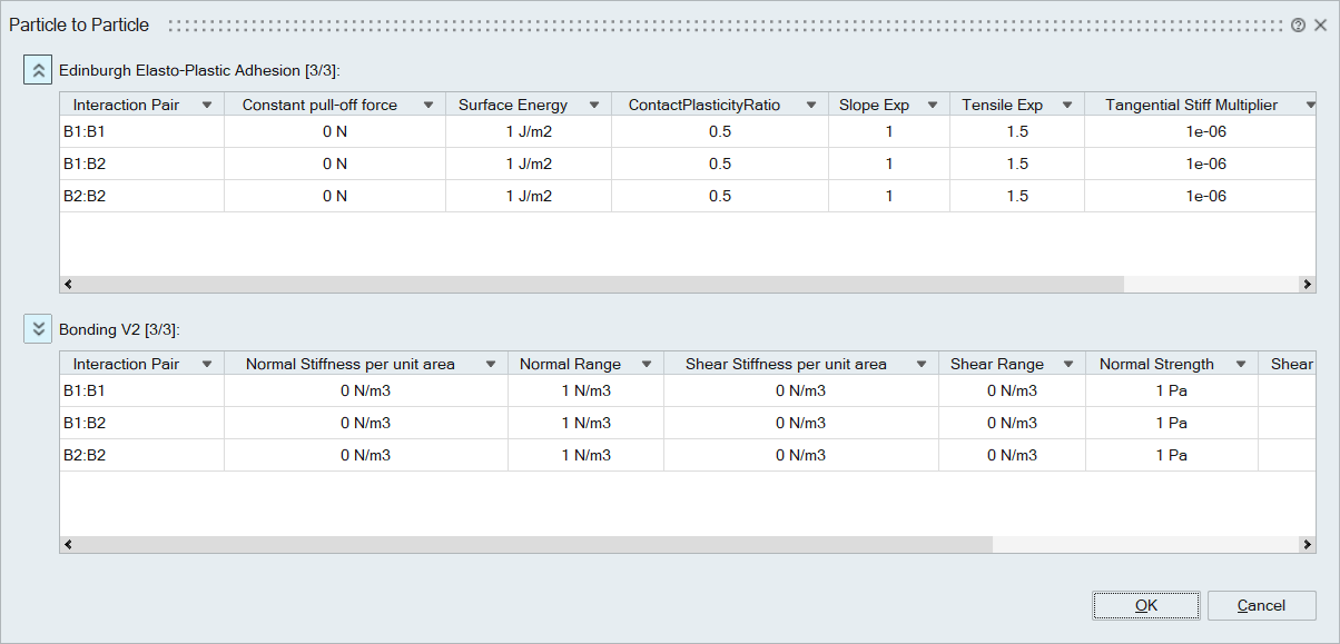

Physics Model Parameters – Review Tool:

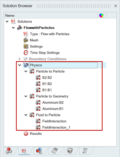

- Right click on Particle to Particle and Particle to Geometry in solution browser will open this review tool.
- This tool used to list the physics models and display the model parameters for each interaction pairs.
- User can review and modify the values for multiple interaction pairs.
