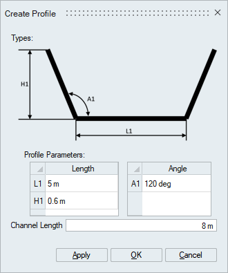

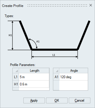

This is used to create the specified profiles for the channel.

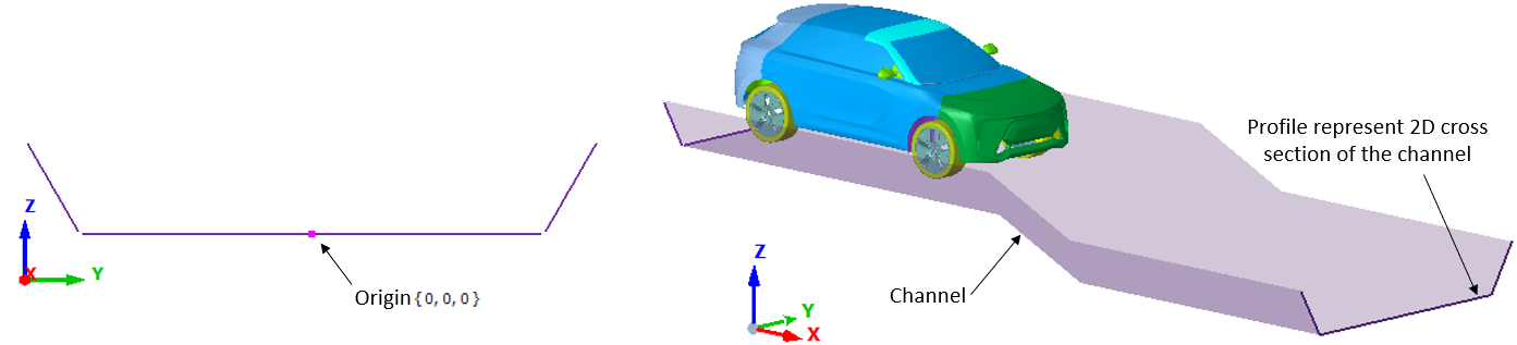

The profile is a wire body and it represents a 2D cross section of the channel.
With origin as a midpoint of the dimension L1, the symmetric profile is created in the YZ plane for the specified dimensions.

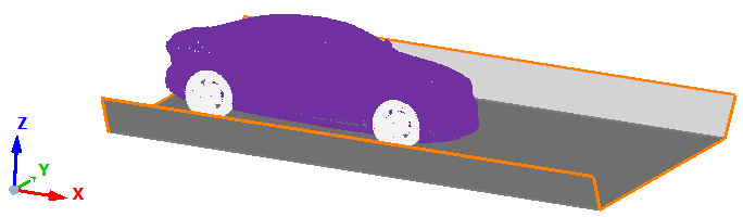

If the simulation type is the static car and moving road, the channel length option is exposed in the dialog as shown below.
The specified profile is extruded along the positive X direction for the given channel length to create a channel.
