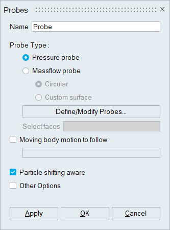

Probes are used to extract accurate post-processing information from particular location, whether we want the information to come from a FLUID or a WALL or a MOVINGWALL phase. In that sense it is possible to define both static and moving probe particles.
  • Volume (Spherical) probe assesses fluid properties.

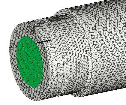

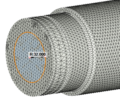

  • Surface (Circular) probe assesses fluid properties (mass flow).
  • Custom Surface (Flowrate probe) is essentially a MASSFLOW equivalent.
  • Solid probe assesses solid body properties.
