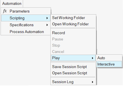

Using SimLab Interactive Play
  1. Start SimLab
  2. Choose Project Menu > Play > Interactive option.
  3. Select a Python script. It will launch Compose and load the selected Python Script in Compose.
  4. Now you can start debugging the selected script with Compose. SimLab Python Function execution will be reflected in SimLab. View Demo
