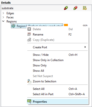

Changing the Waveguide to a Shell (Hollow) Part
Change the solid waveguide part to a shell (hollow) part with metal walls.
