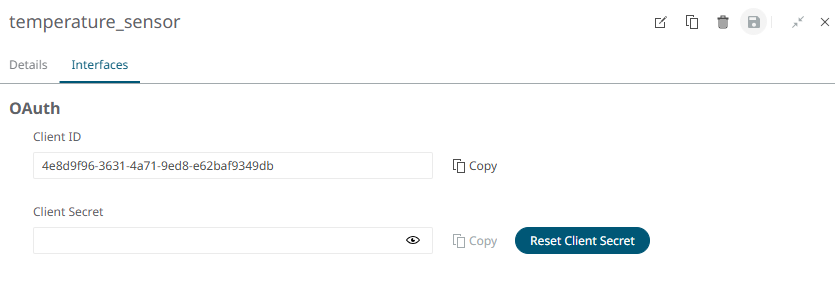

    Note: The Application Client ID and Client Secret are required to configure the New Workbook in the Real time Visualization module. Be sure to capture and save this information.

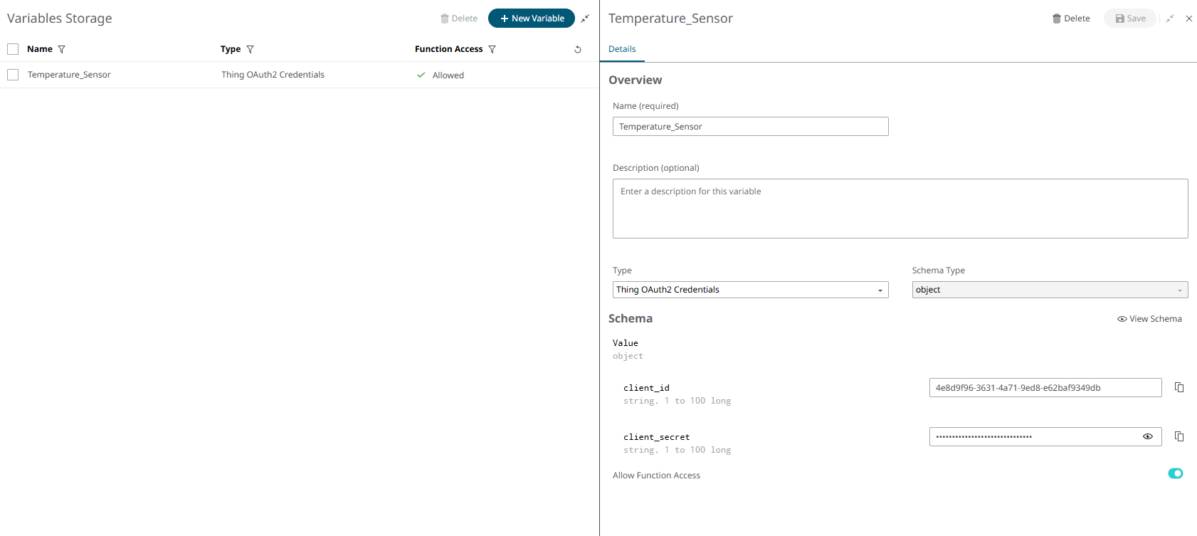

    If you click to reset your Client Secret, you can save it in the Variables Storage section under Space Settings and access it later.
