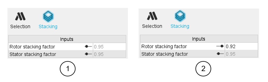

The stacking factor is managed at the design stage
The stacking factor of a lamination can be modified directly in the design context of Motor Factory.
The default stacking factor for the lamination is defined in Material Manager. Then, the user can adjust the stacking factor in the Motor Factory - Design area if the default value is not a satisfying one.
Table 1. Building the winding architecture – Choice of winding MATERIALS - Conductor and insulation
1 The default values of the stacking factors correspond to what is defined in Material Manager.
2 If users are not happy with the default value, they can adjust the stacking factor by switching to the user input and then writing the desired value.
Note: By the fact that the stacking factor is adjustable in Motor Factory, it can be considered as input of any HyperStudy connectors. Consequently, users can study the influence of the stacking factor on machine performance automatically via HyperStudy.
