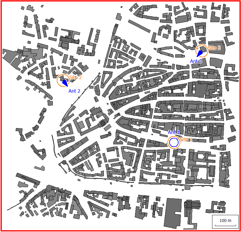

The geometry is described by urban buildings, see Figure 1. The database was
not preprocessed.
Sites and Antennas
The model has three sites with three different antennas placed at different locations
and heights of 18 m and 20 m, respectively. The frequencies of the three antennas
are 2 GHz, 1.8 GHz, and 0.9 GHz, respectively. Figure 1. The urban overview of the model.

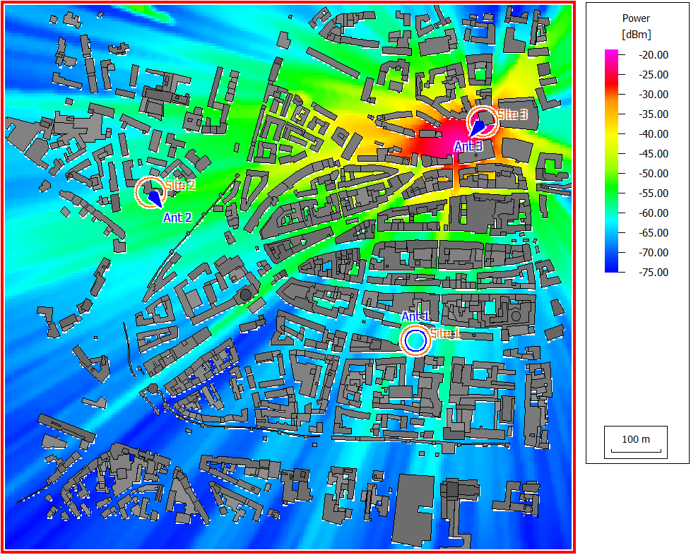

Figure 2. The power results for Site 3 Ant 3.
Results
Propagation results show at every location the power received from each individual
transmitting antenna. Figure 2 shows the results for Site 3 Antenna 3 at a receiver height of
1.5 m.
