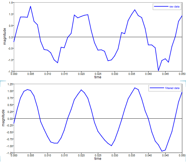

Example
Filter a noisy sine wave with a third order filter fitted to groups of seven.
% define noisy signal
f = 62.5;
omega = 2*pi*f;
fs = 1000;
ts = 1/fs;
n = 50;
t = [0:ts:n*ts];
signal = sin(omega*t);
rand('seed', 2025);
noise = normrnd(0, 0.2, 1, n+1);
signal = signal + noise;
% filter signal and plot
F = sgolay(3, 7, 0, ts);
signalSG = sgolayfilt(signal, F);
subplot(2,1,1);
plot(t,signal);
xlabel('time');
ylabel('magnitude');
legend('raw data');
subplot(2,1,2);
plot(t,signalSG);
xlabel('time');
legend('filtered data');
1. filter figure 1
