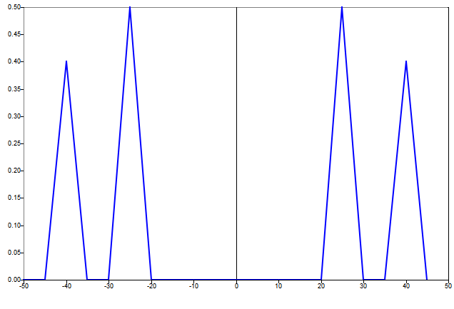

Example
fft of signal with two frequency components.
This example is the same as for fft, but with fftshift applied and the frequency axis shifted to show the negative frequencies to the left of 0.
f1 = 25;                 % first frequency component
f2 = 40;                 % second frequency component
fs = 100;                % sampling frequency
ts = 1/fs;               % sampling time interval
n = 20;	                 % number of samples
t = [0:ts:(n-1)*ts];  % time vector
signal = sin(2*pi*f1*t) + 0.8 * sin(2*pi*f2*t);
ft = fft(signal) / n;    % normalized fft
fq = freq(n,fs,'shift'); % frequency vector
plot(fq, fftshift(abs(ft)));
図 1. fft figure 1
The frequency spacing is 5 Hz, so both components fall exactly on one of the frequency vector values.
