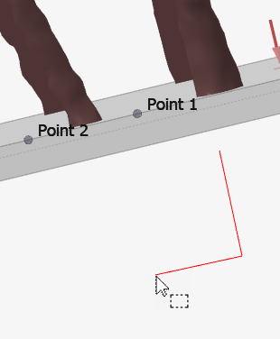

On the PolyNURBS ribbon, select the Pave tool.
Tip: To find and open a tool, press Ctrl+F. For more information, see Find and Search for Tools. - Select points, reference points, or edges to define a rectangle. A PolyNURBS surface is automatically created
To add another face to the PolyNURBS surface, click an open edge on the surface, and then place two more points.
