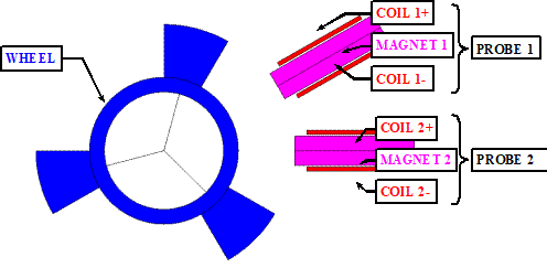

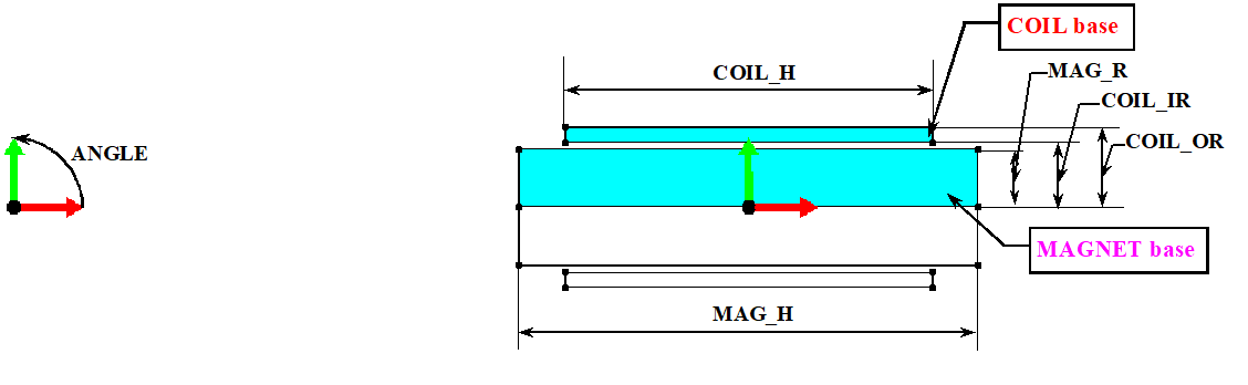

To describe the device represented in the figure below, several geometric parameters are used to describe magnets and coils.
