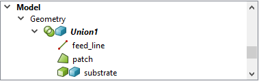

Unioning the Geometry for Mesh Connectivity
Union the geometry (feed_line, patch and substrate) to create a single geometry part. A single geometry part will ensure mesh connectivity when the model is meshed.
