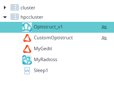

The
indicates that it is a shared application
definition.Note: Delete is the only option that will be available till you save the application definition locally. -

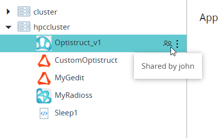

Click
to view the user who has shared the application
definition.

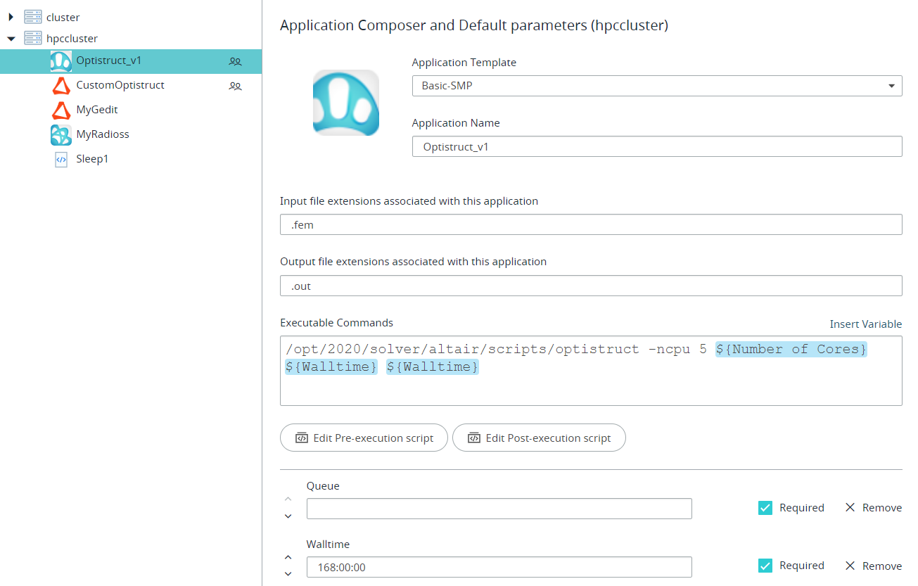

Click the application definition to save it as a local copy.
The application definition parameters are displayed in the Compose panel.
Figure 3. Review Shared Application Definition

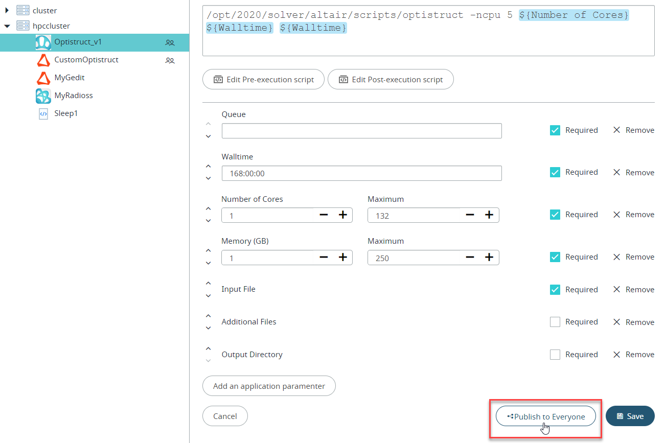

Review the application definition and edit the application definition if required before publishing the application definition to all the users.
Click Publish to Everyone.
Figure 4. Publish Shared Application Definition

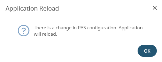

The application definition will be published to all the users making it a global application definition and a notification will be displayed.
Access Web will get a notification that application definition has been updated.

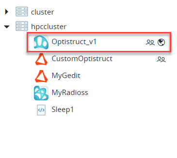

The application definition that is published will get updated in the application list with
icon.Figure 5. Global Application Definition
