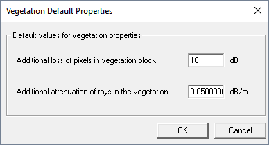

- Vegetation Objects
- Vegetation data can be considered optionally. Vegetation blocks can be
included either as vector objects or based on a pixel database, which can be
specified additionally. If no vector vegetation objects are already
contained in the database, a pixel database describing vegetation can be
specified using the Change button.
For both vector and pixel based vegetation objects material properties can be specified. If pixel based vegetation objects are used or if the user does not want to use the properties defined for vegetation objects in the vector database, new values can be used by clicking Default values. In this case, all vegetation blocks are assigned the same values, independent of possible definitions in the vector database. Individually defined properties are not taken into account for vector based vegetation blocks, for all vegetation objects the same material properties are used. The default values can be changed by using the Change button. After clicking on the button, the dialog for the definition of the vegetation properties appears.
