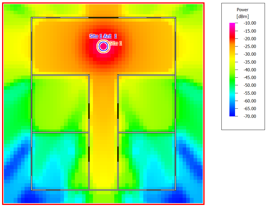

Results
Propagation results show, at every location, the power received from the transmitting
antenna. The results are shown for a prediction plane at a height of 1.5 m from the
floor. Figure 1. Received power for the empirical coefficients.
