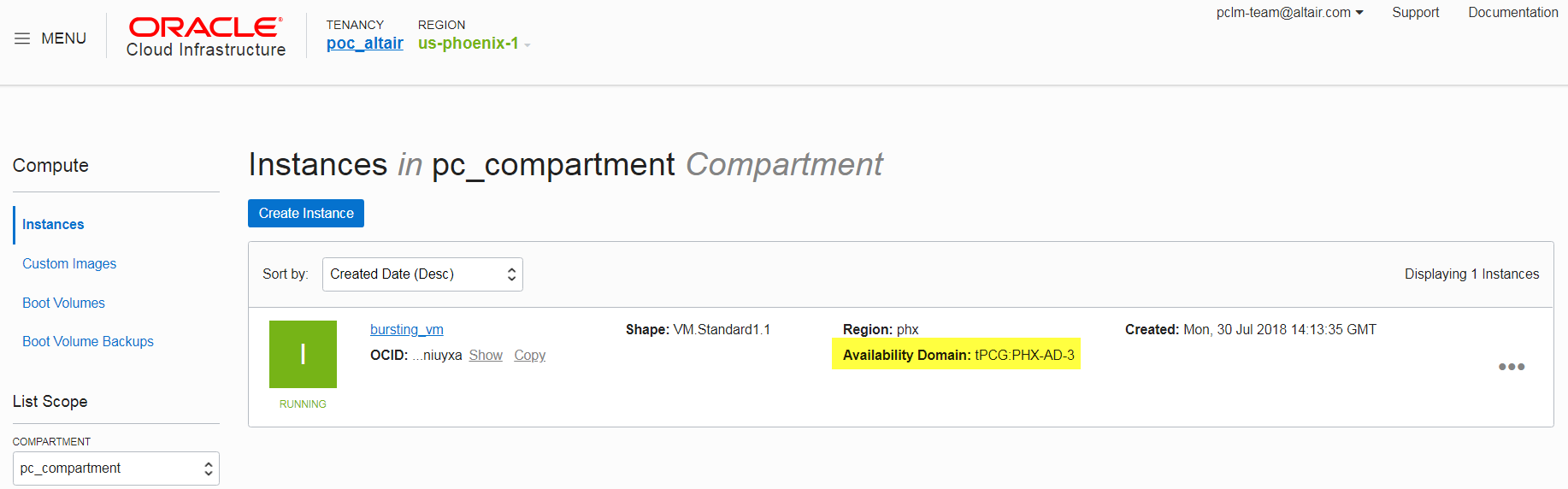

                For Region, select the availability domain where the
                    cloud bursting virtual machine is hosted.
Figure 1. Virtual Machine Availability Domain

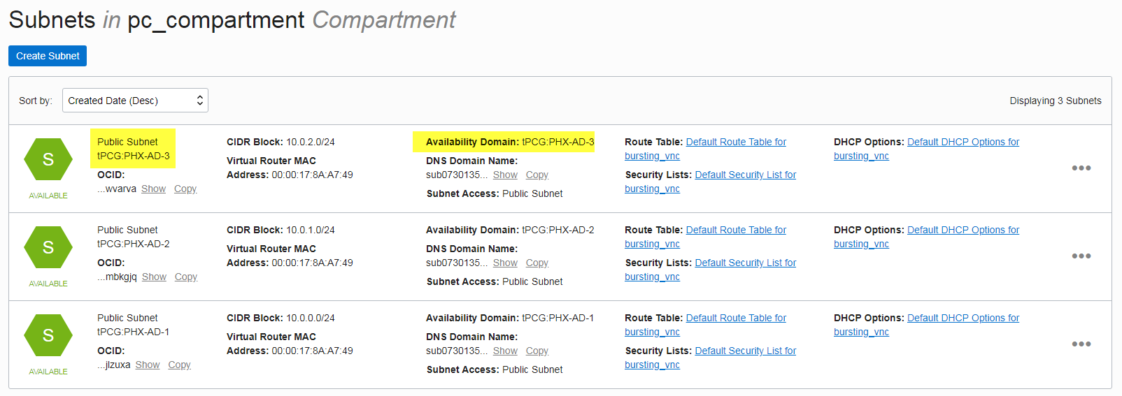

 - Click the name of the VCN created for cloud bursting.
                Locate the subnet associated with the availability domain where the cloud
Figure 2. Subnet and Associated Availability Domain
                Click Show located under the name of the subnet.
                The subnet's OCID is displayed.
 - Click Copy to copy the OCID.
