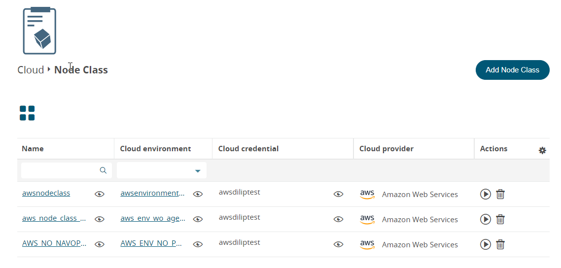

The list of available Node Class is displayed. You can search and filter the list by Name, Cloud environment, Cloud credential and other criteria.
Figure 1. List of Node Class
To manually deploy a Node Class, click deploy (
) in the
Actions column.
