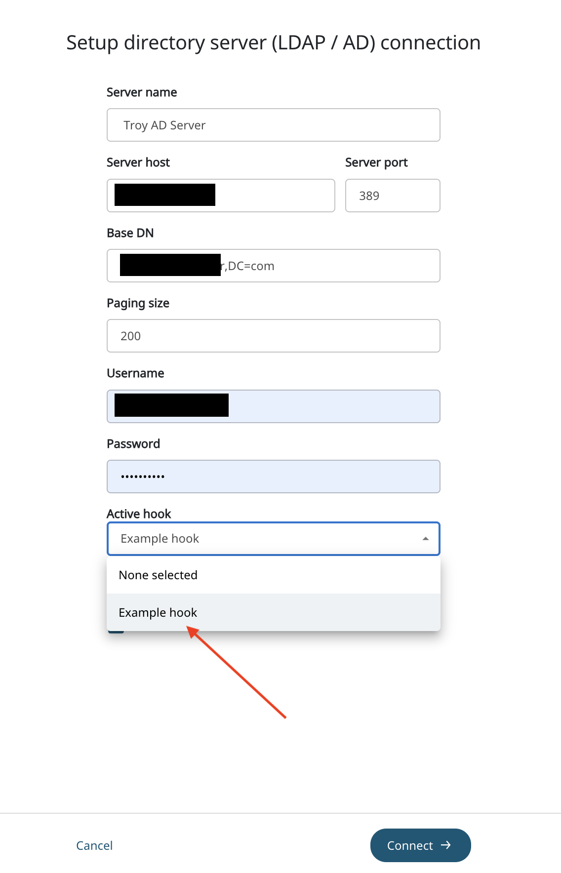

  4. Select the hook that you created. By default, the active hooks configured will be displayed during the data import.
    Figure 4. Select Python Hook
  5. Select the hook that is created and click Connect.
    The Organization Hierarchy service will use this hook during the data import.
    As a result in the next step of data import the Attributes will be selected and it will manipulate the attribute based on the hook (Example Hook).
    Figure 5. Python Hook Attribute
    The Example Hook selected is used during the data import and it creates new attributes like country and email_name. The department values are suffixed with (transformed) word.
