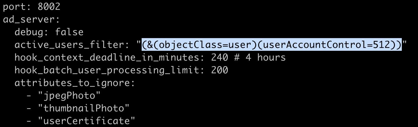

Once the filter is finalized, configure it in the Org Hierarchy service configuration file (<IPLA_Installation_Location>/home/config/org_hierarchy_services/config.yaml), as shown below.
Restart the InsightPro for License Analytics to make the changes effective using the command: inpro-lic set service --start.
Now, any new Data Import will make use of this filter.
