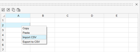

  3. Other data import and export options include:
    • Click to import data from a CSV file.
    • Click to export the table's data to a CSV file.
    • Click or to copy and paste data, respectively.
    • You can also right-click within a table cell to display the table's context menu.

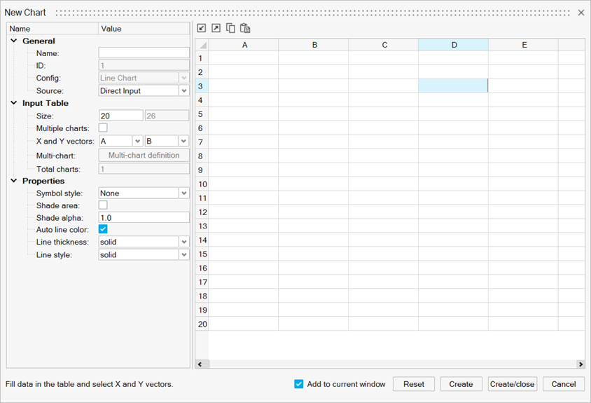

Input Table
The Input Table section is displayed when you select the Direct Input and HM table source types. Some options change, depending on the input type selected.
Size
The number of entries in the data table. You can only change the number of rows.
Note: Only displayed when Direct input is selected.

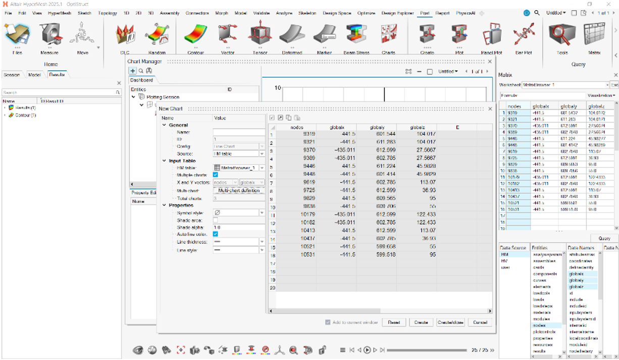

HM table
If you select HM table for the source type, this field is displayed. From the drop-down menu, select the HyperMesh table that you created, including those created from the Matrix Browser.
Figure 3.

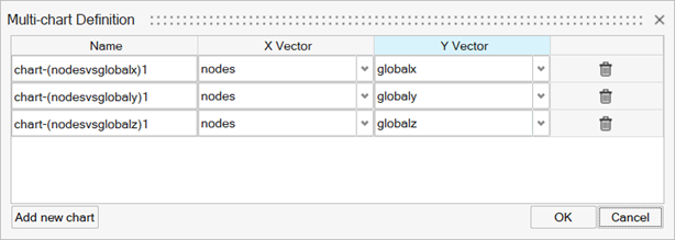

Multiple charts/Multi-chart
Activate this option to define multiple charts and output them simultaneously.
Click Multi-chart Definition to display the following dialog:
Figure 4.
Click Add new chart to add a new chart to the table.
Upon selecting options for the X Vector and Y Vector columns, click OK.
X and Y vectors
Define the columns for the X and Y vector values.
This option is disabled if HM table is the input type and if Multiple charts is selected.
Total charts
The total number of charts that you have created. The value changes if Multiple charts is selected.

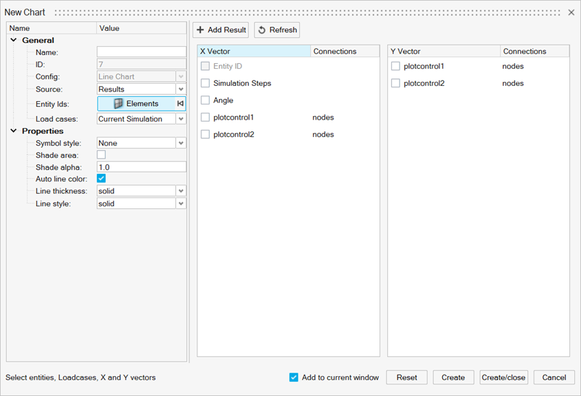

Results
From the Source menu, select Results. Use results data and cross plotting options to create multiple charts from the X Vector and Y Vector table.
Figure 5.
Entity IDs
Select nodes or elements from model. During this process, the Chart Manager dialogs are minimized to simplify your selections.
On the guide bar, click to apply your selections, close the tool, and return to the Chart Manager.
Click to exit the tool without applying your selections.
Load cases
Select one of the following types:
  • Current Simulation
  • Current Subcase
  • Advanced Selections. If selected, click ResultSimulation to display the Select Results Simulation dialog. From this dialog, select the simulation to plot.
