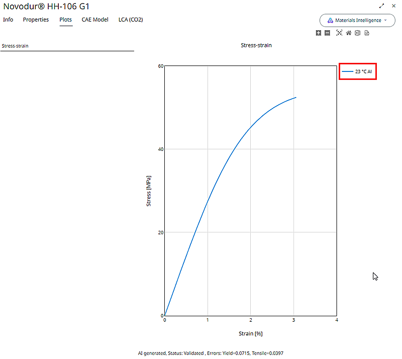

- For curves, the source of the data is indicated in the label. In this
example,
23°C
AI indicates that this curve has been predicted by AI.
Figure 2. Borrowed Data with the label AI
