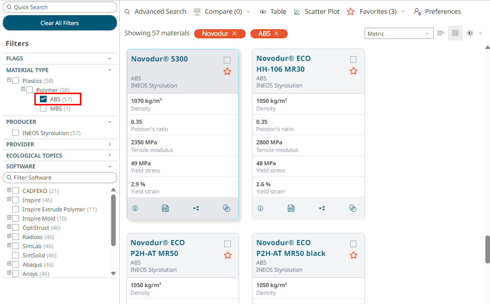

To fill missing property values for stress-strain curves and related properties with AI predicted data for a material:
Select a material data set.
In the following example, ABS material data set from Polymer is selected.The material database is filtered and displays the results.
Figure 1. Select Material
