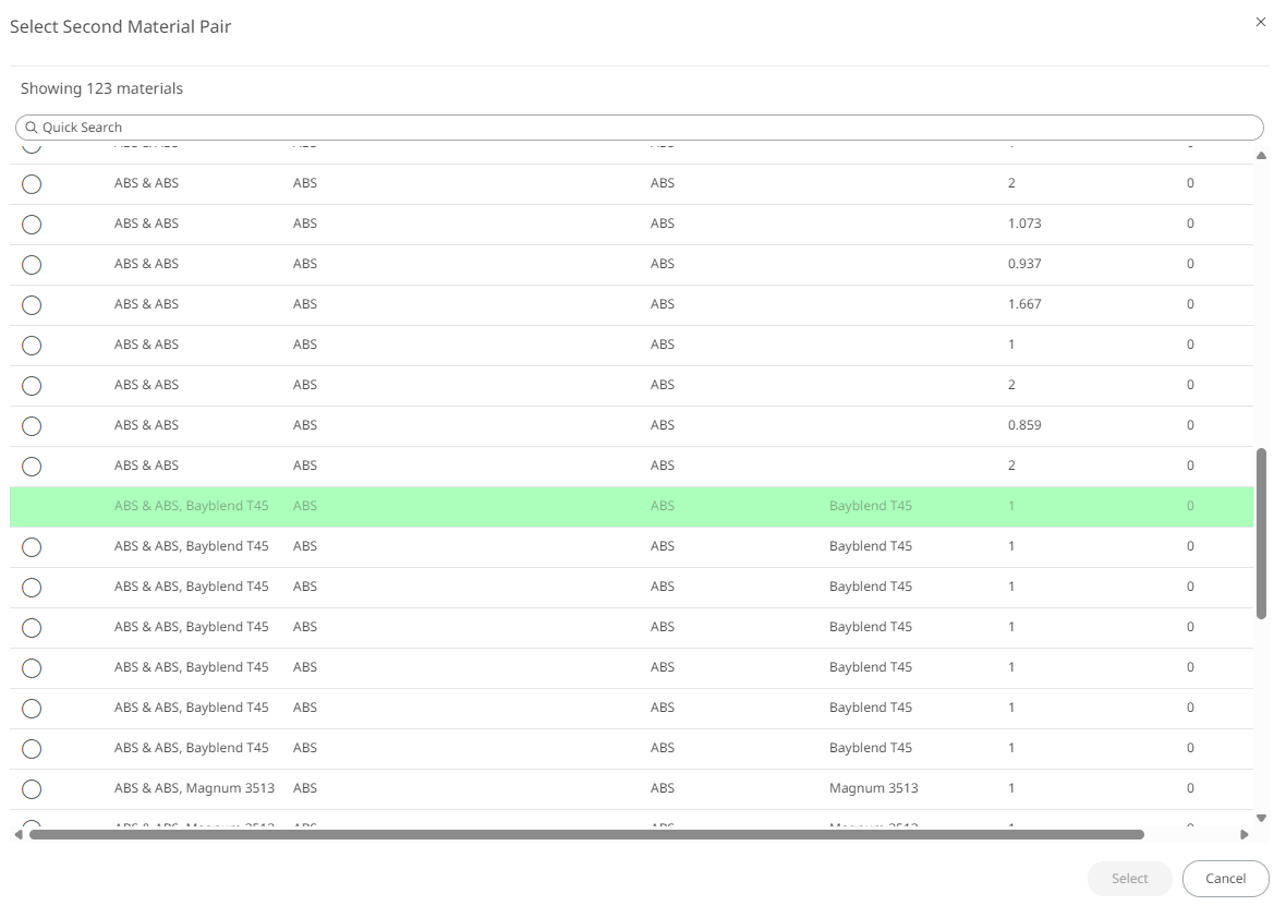

  5. If you do not want the suggested second material pair you can choose a different material pair. Click the Select Another Pair link from the SMDC suggested Material Pair 2 preview.
    1. Select the required material pair from the Select Second Material Pair window. For your reference, the selected first material pair is highlighted in green.
      Figure 2. Select Second Material Pair
      Note: Use the Quick Search field to filter the list and select the required material pair.
