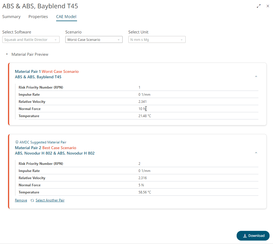

  3. Click the CAE Model tab.
    The Select Software displays Squeak and Rattle Director as already chosen.
  4. Select a scenario from the Scenario list. By default, the Worst Case Scenario is chosen.
    Figure 1. Material Pair Preview
    The Material Pair Preview displays the following:
    • Material Pair 1 Worst Case Scenario (selected by default): Displays important material properties including impulse rate value for the worst-case scenario for the selected material pair.
    • Material Pair 2 Best Case Scenario: Based on your selection, SMDC suggests the opposite scenario. In the current example, SMDC suggests best-case scenario with lower impulse rate value and other material properties for the same selected material pair.

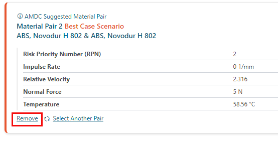

  5. To download only a single pair of the selected scenario material data, click Remove from Material Pair 2 preview.
    Figure 2. Remove Material Pair 2
    The second material pair suggested by SMDC will be removed.
