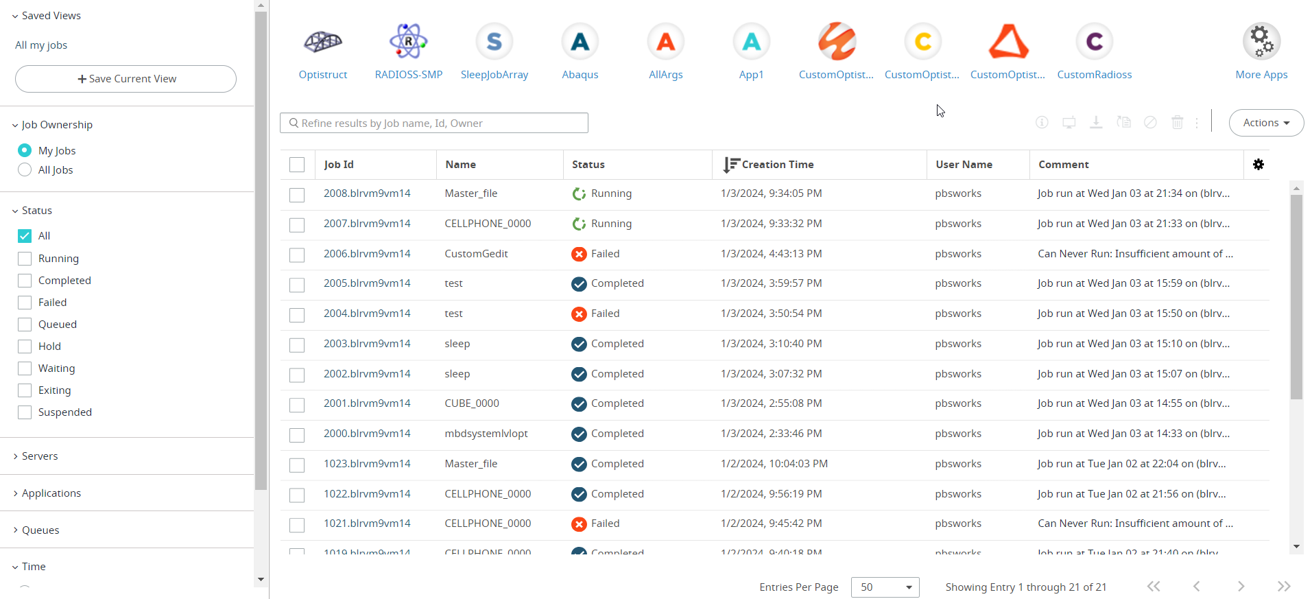

                    Click the Jobs tab located in the upper left-hand of the page.
                The job monitoring page is displayed with the list of your jobs.
Figure 1. Job Summary View

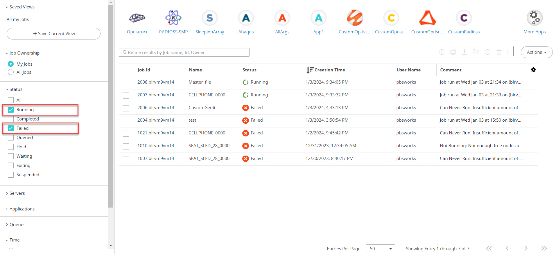

                Select the check box of the filter options based on your requirements.
                For example, you can select a subset of jobs such as: all your jobs that are submitted to ShellScript solver which are queued on a particular server.Note: You can also search for a particular job based on the Job ID and Job Name using the Search option. The Search criteria will be applied to the Save Filter.The job monitoring list will automatically populate with the jobs that match the filter criteria.Note: If you select All Jobs filter, then you will not be able to view the input files, output files and running folder files of jobs belonging to other users.
Figure 2. Filter Option
