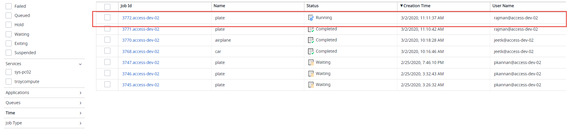

Submit a job to the server. In this example, a Optistruct job
(3772.access-dev-02) is submitted to
troycompute server.
When you view all the jobs, the Optistruct job (3772.access-dev-02) is listed in the Job Monitoring page.
Figure 1. Job Monitoring

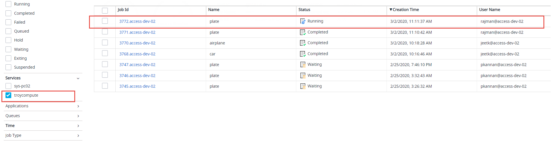

Use the filter to view the jobs that is submitted to
troycompute server.
The Optistruct job (3772.access-dev-02) will be listed in the Job Monitoring page.
Figure 2. Jobs in troycompute Server

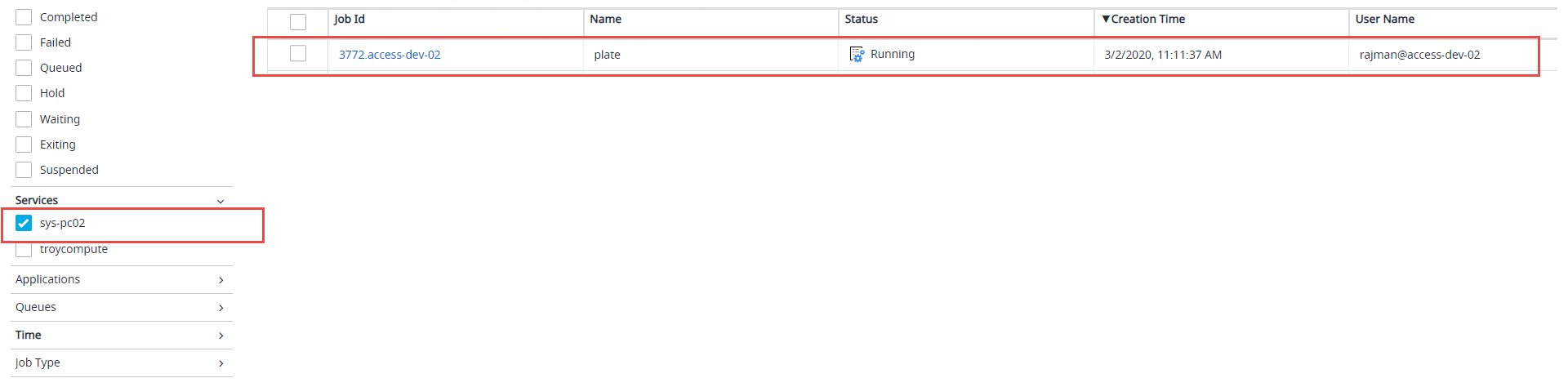

Change the Server filter to view the jobs in sys-pc02
server.
The Optistruct job (3772.access-dev-02) will be listed in the Job Monitoring page as it is moved from troycompute to sys-pc02 server.
