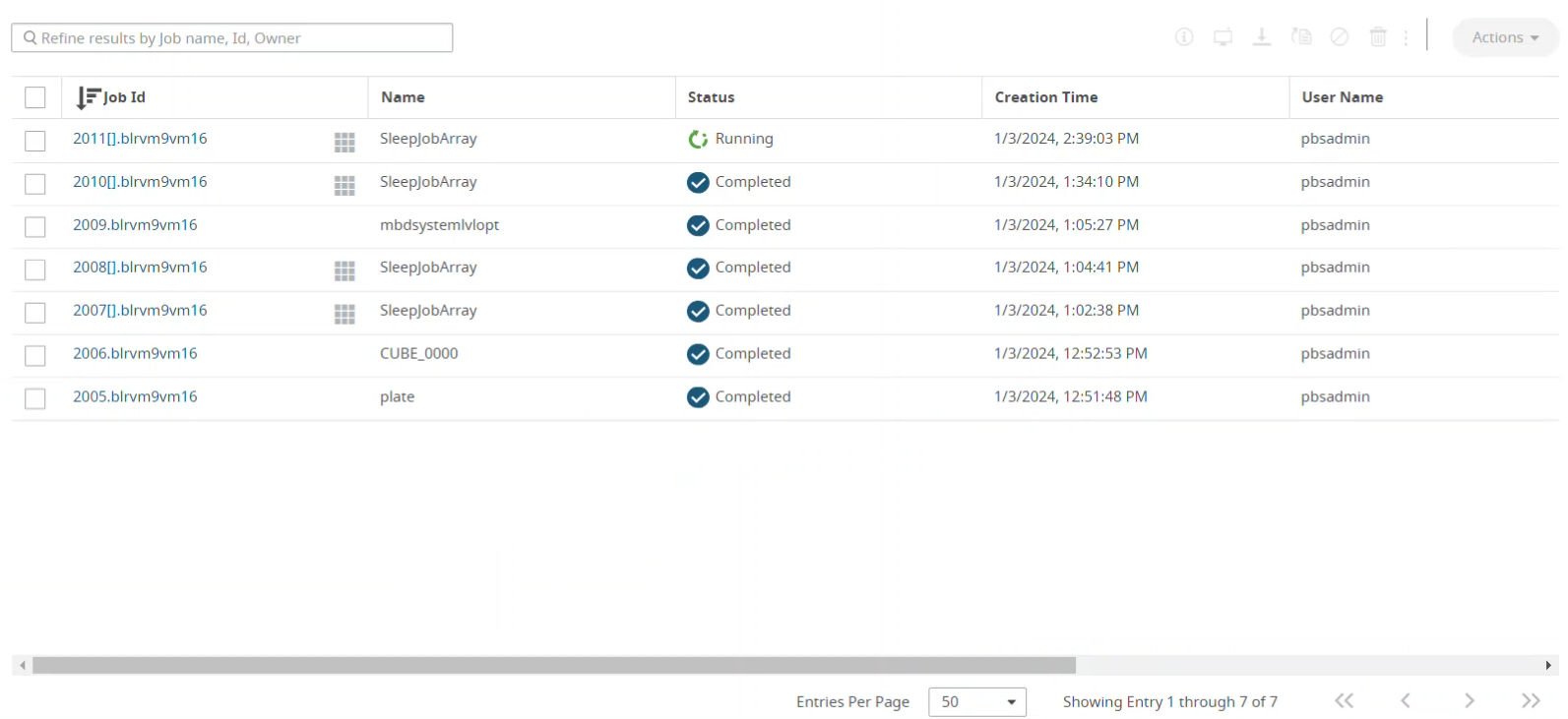

  1. Click the Jobs tab located in the upper left-hand of the page.
    The job monitoring page is displayed with the list of the jobs that is submitted to a cluster.
    Figure 1. Job Monitoring View
    Job Monitoring View
    Note: Job arrays are indicated with "[]" braces with the Job ID and it is also indicated with the icon in the Job ID column.

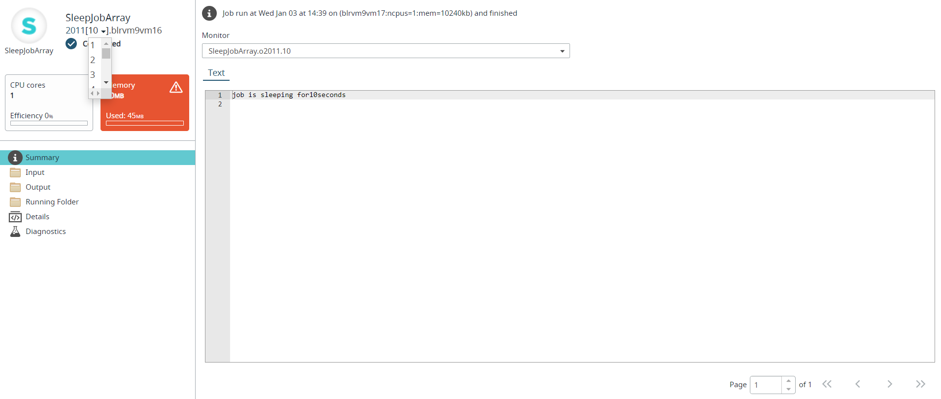

  3. Perform one of the following options:
    • Double-click the sub job name.
    • Right click the sub job and click the View Details from the context menu.
    The sub job of the batch job is displayed.
    Figure 3. Sub Jobs Details
    Sub Jobs Details
    Tip: You can use the drop-down option located next to the Jobs name and select a particular subjob to view its details.
