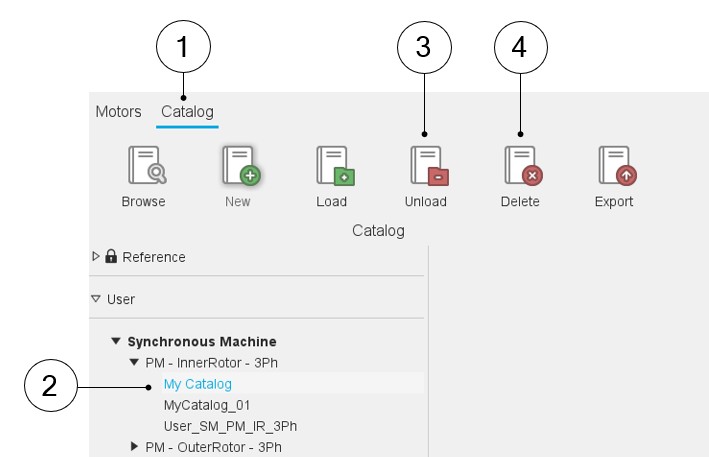

How to unload a catalog?
- Unload a catalog means to cut the link between the folder corresponding to the catalog and Motor Catalog application. However, the folder is not removed. It still exists after having been unloaded and it can be reloaded if needed.
- Delete a catalog means to remove the folder corresponding to the catalog.
In that case all its content will be deleted and can’t be reloaded.
How to Unload or Delete a catalog is illustrated below.
| 1 | Selection of the catalog area of the Motor Catalog application. |
| 2 | Selection of the catalog to Unload or to Delete. |
| 3 | Button to Unload the selected catalog. |
| 4 | Button to Delete the selected catalog. |
