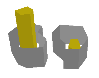

In WallMan buildings that are surrounded by other buildings
are by default removed. To prevent that it is possible to declare a building inside another
one either as courtyard (if it is lower than the surrounding) or as tower (if it is
higher).Figure 1. Tower and courtyard in urban database.
