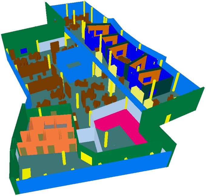

The basis for any propagation model is a data base which describes the propagation environment. Considering indoor propagation suggests, for the purpose of propagation modeling, that each building element should be categorized into classes (wall, floor, door, window) and specified by its coordinates and finally its material properties (thickness, permittivity, conductivity).
![](../../../../../images/winprop/user_guide/proman/propagation_projects/indoor_3d_building_database.jpeg)
