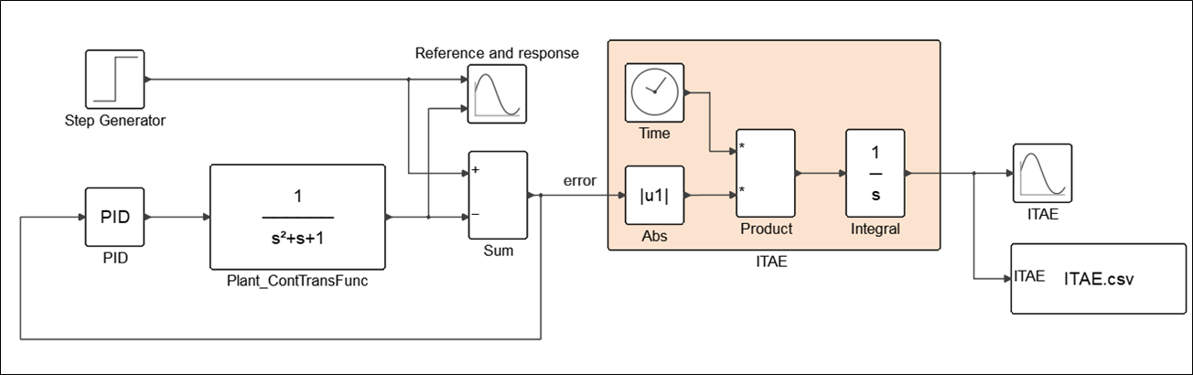

  6. Display Results: Use scopes to display:
    • The system response (y(t))
    • The accumulated ITAE value
Figure 1. The PID Model with ITAE

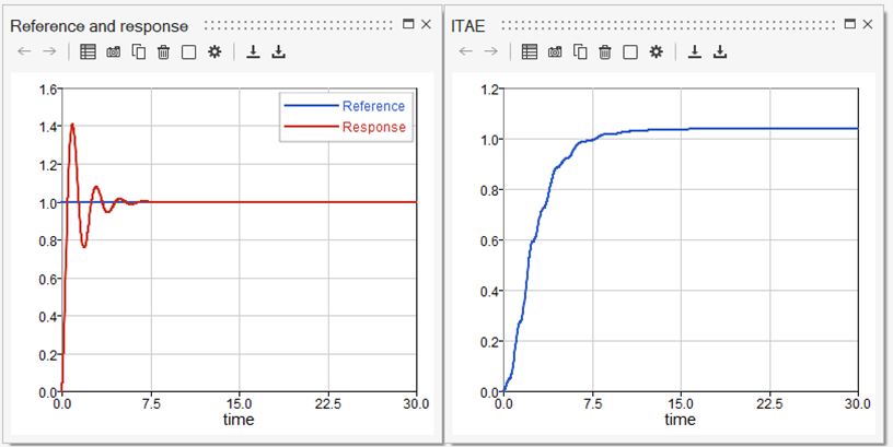

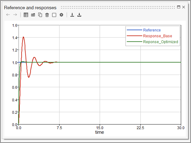

    • The figure below shows the reference and response signals, along with the nature of ITAE of this model for the base model.
Figure 2. Reference and Response Signals and ITAE Before Optimization

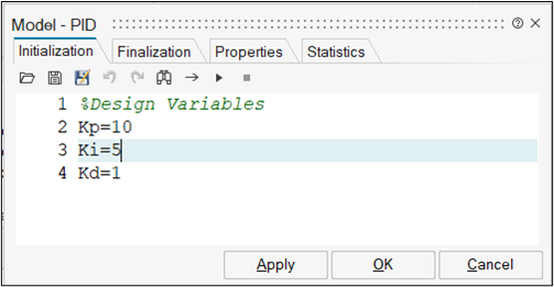

  1. Add the following values of Kp, Ki, Kd to the initialization script:
    • Kp=10
    • Ki=5
    • Kd=1
    Figure 3. Initialization Script Where Design Variables are Declared

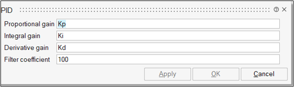

    Use these variables in the PID block.
    Figure 4. Variables Used to Define the Gains in the PID Block

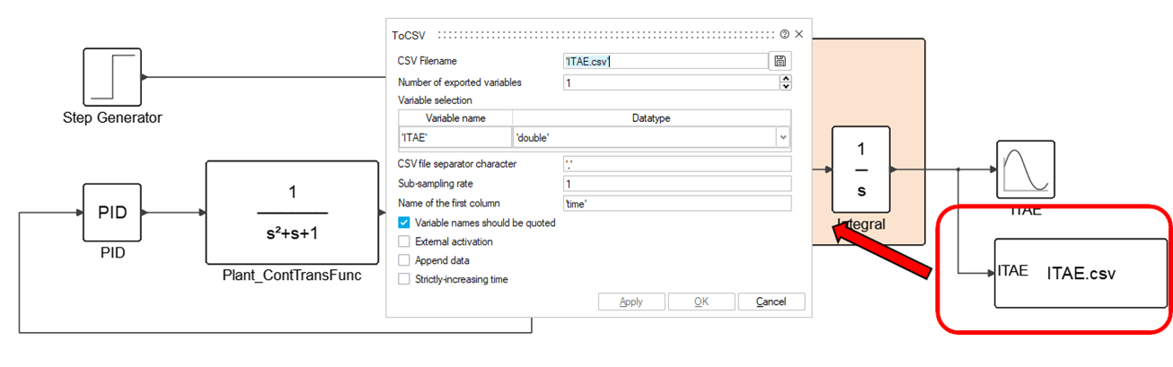

  2. Add a ToCSV block with the following values:
    • CSV Filename: 'ITAE.csv'
    • Number of exported variables: 1
    • Variable name: 'ITAE', Datatype: 'double'
    • Sub-sampling rate: 1
    • Name of the first column: 'time'
    • Select Variable names should be quoted
    When HyperStudy calls Twin Activate during any run, it expects that a CSV file is created. This CSV file is used as an output source. It should contain all the response vectors that are required in HyperStudy.
    In this case, you need to dump the ITAE values, into a CSV file. The final value of this vector is used in HyperStudy to define a response.
    Figure 5. The PID model with ITAE
    The model is now ready to be linked with HyperStudy.

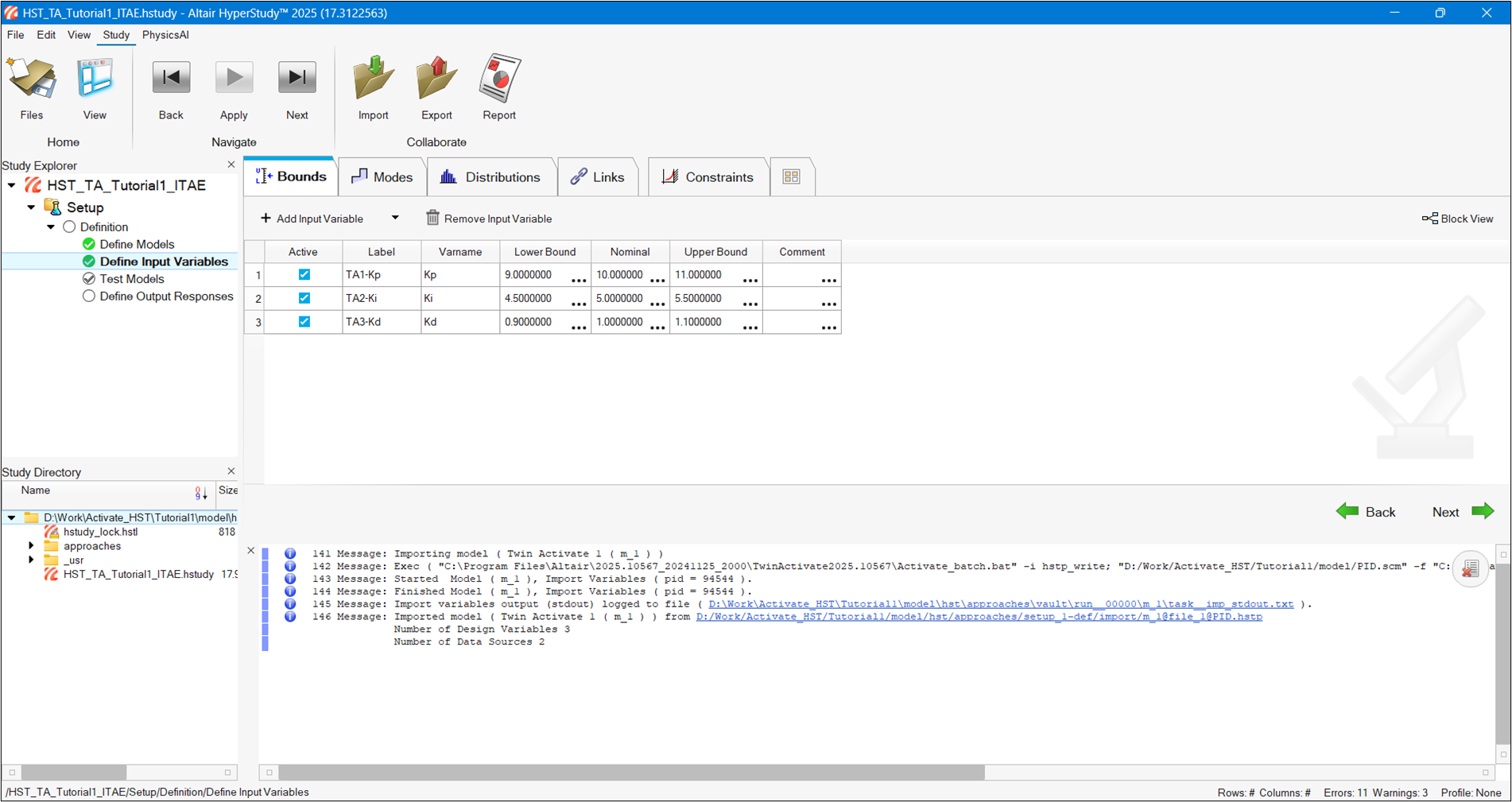

  4. Click Import or Import Variables to import all the design variables defined in the initialization script of the Twin Activate file.
    Note: All independent variables are imported as design variables in HyperStudy. The Define Input Variables tab looks like the image below.
    Figure 7. Design Variables in HyperStudy

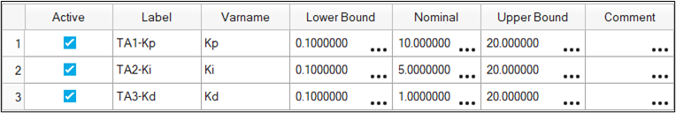

  5. Change the lower and upper bounds to 0.1 and 20, respectively, for all three design variables.
    Figure 8. Upper and Lower Bounds

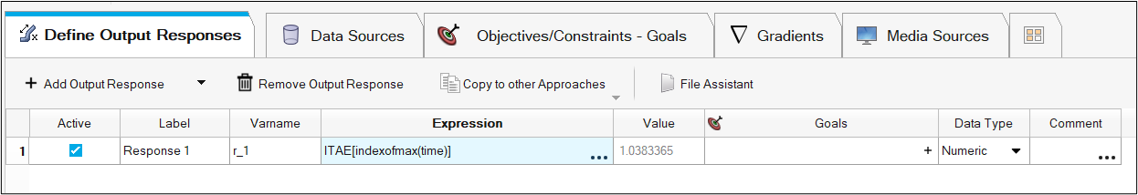

  7. Click Define Output Responses.
  8. Click Data Sources.
    You should see that two output data sources have been added: ToCSV_time and ToCSV_ITAE. These represent the two columns of data from the ITAE.csv file. You only need the last value of the ToCSV_ITAE vector.
  9. Click Define Output Responses, and then click Add Output Response.
  10. Under expression type, enter ITAE[indexofmax(time)], and then click Evaluate.
    The last value is now shown in the Value column.
    Figure 10. Using the Last Value of ITAE as a Response

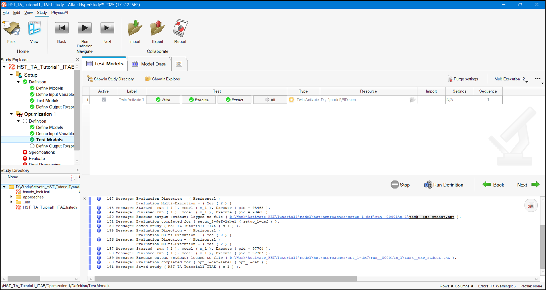

  13. From the Test Models tab in the browser, click Run Definition.
    Ensure the model runs without any errors.
    Figure 11. Running the Model in the Optimization Study

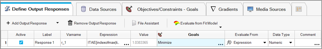

  14. From the Define Output Responses tab in the browser on the left, select Minimize > Goals.
    The optimization algorithm tries to minimize the value of last value of ITAE.
    Note: You might have to click Evaluate to populate the value of the response.
    Figure 12. Defining the Goal in HyperStudy

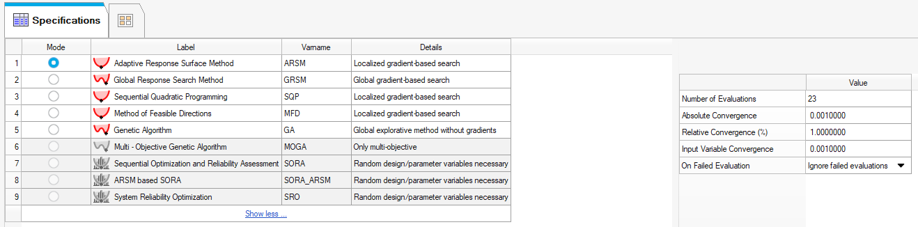

  16. Select the Adaptive Response Surface Method as the optimization mode on the left side of the tab. Set the following parameters on the right side:
    • Number of Evaluations: 23
    • Absolute Convergence: 0.001
    • Relative Convergence (%): 1.000
    • Input Variable Convergence: 0.001
    • On Failed Evaluation: Ignore failed evaluations
    Click Apply to use the modified settings.
    Figure 13. Optimizer Settings

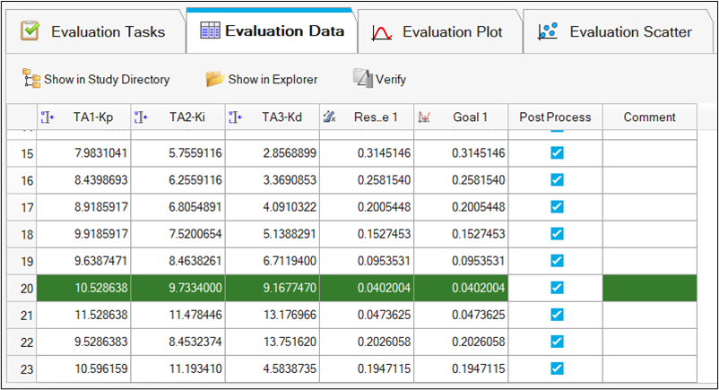

  17. Open the Evaluate tab in the browser, and then click Evaluate Tasks.
    When the optimization is complete, look for the row highlighted in green. This lists the optimized value of ITAE and the corresponding design variable values (Initial: 1.038; Optimized: 0.0402).
    Figure 14. Optimum Values of Design Variables

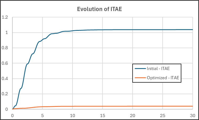

    The CSV files from run folder 20 (optimized solution) can be compared with the initial value in run folder 1.
    Figure 15. Reduction of ITAE using Optimized Values of the Design Variables
    Figure 16. Comparison of Response from Base Values of PID and Optimized Values of PID
    As can be seen in the above figure, the response from the optimized values of Kp, Ki, Kd happen to produce a much smoother and better response.
