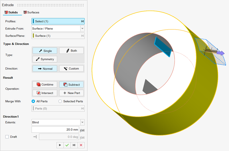

    The guide panel appears.
  2. Choose the entity type that you'd like to create:
    • Solids: Extrude as solids.
    • Surfaces: Extrude as 3D surfaces with optional end caps.

  4. Choose a setting from Extrude From to indicate where the extrusion starts:
    • Profile: Extrude from the selected profile.
    • Surface/Plane: Use the Surface/Plane collector to select the surface or plane from which you want to extrude the profile.
    • Offset: Use the Offset box to specify the distance and direction you want to offset the extrusion from the selected surface.

  7. Choose a Result type:
    • Combine (only available for Solids): Merge the extruded shape with the existing parts.
    • Subtract (only available for Solids): Carve out the extruded shape from the existing parts.
    • Intersect (only available for Solids): Retain only the intersecting portions of the extruded shape and the existing parts.
    • New Part: Create a new part from the extruded shape.
