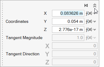

  4. To edit points during creation, click the in the microdialog to expand it and type values in the X, Y, or Z boxes to fine-tune each point's coordinates. To add a variable to any coordinate, select the
    icon.
    Tip:
    • To reset the curve to automatic tangent behavior, click Auto Tangent .
    • To set the tangent direction Z to be double the X value, enter 1 in the X value and 2 in the Z value.

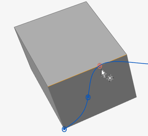

    • To suspend snapping, hold Alt. You can then move the point freely along its current face or edge.
      Figure 1. Suspend Face Snapping
      Figure 2. Suspend Edge Snapping
