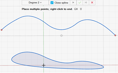

To sketch this Do this Spline Through Points
Click to place each fit point of the spline. To change the magnitude of a spline, click the
Spline Using Control Points
Click to place each control point of the spline.  - Right-click and mouse through the check mark to exit, or double-right-click.

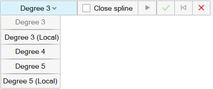

To Do this Define the degree In the guide bar, select from: - Degree 2
 - Degree 3
 - Degree 4
 - Degree 5
Close the spline on creation In the guide bar, turn on Close spline. Add a point Select the spline, then hover over the curve between two points until you see a reference point with a + icon. Click on the reference point to add an additional point. Reposition a point - Drag the point, or

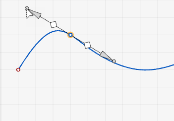

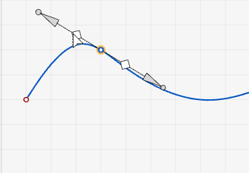

Change the tangency Drag the diamond control to adjust the tangent curve:
Note: Available only for splines created with the Spline Through Points tool
                                        Change the magnitude Drag from the arrowhead at either end of the tangent line:
                                        Change the tangency and magnitude simulataneously Drag the point at either end of the tangent line:
