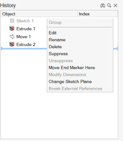

Figure 2. History Browser Context Menu - Sketch

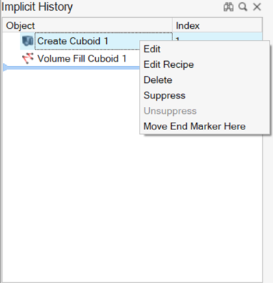

Figure 3. History Browser Context Menu - Implicit
Note: Right-click to open the context menu. Some options are not available for all construction features.

Modify Dimensions
This option allows you to change the dimensions of an existing sketch. (Available for sketch construction features only.)
For more information, see Dimension.
Change Sketch Plane
This option allows you to change the sketch plane of an existing sketch. (Available for sketch construction features only.)
For more information, see How Do I Move a Sketch Entity?.
