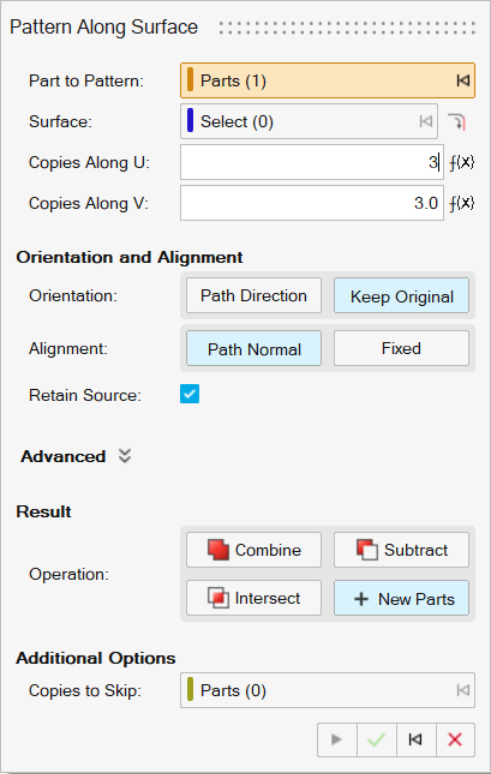

Along Surface
Pattern parts or faces along a surface.
                On the Geometry ribbon, select the Along
                        Surface tool.
Note: The tool may be hidden in the dropdown menu. To access the dropdown menu, you can do one of the following:- Select
 at the lower
                                right corner of the currently displayed tool. - Click and hold the currently displayed tool.
The guide panel appears.
 - Select
                Select the part you want to pattern along a surface:
- In the guide panel, next to Part to Pattern, click the Select button.
 - In the modeling window, select the part you want to pattern.
Note: To deselect a feature, hold down Ctrl while clicking. To clear all selected features, click Reset
 in the guide
                        panel. -
                Define the surface:
- In the guide panel, next to Surface, click the Select button.
 - In the modeling window, select the surface the pattern will follow.
 - (Optional): Select
Tangent Propagation so
                            that clicking an edge will also select all of its tangent edges.
                Adjust the pattern:
To Do this Change the number of copies in the U direction Enter the number of Copies Along U. Change the number of copies in the V direction Enter the number of Copies Along V.  -
                Choose the orientation of the first copy:
- Path Direction: Orient the first copy to follow the surface.
 - Keep Original: Orient the first copy to match the source entity.
                Choose the alignment of the subsequent copies:
- Path Normal: Each copy is aligned along the normal of the surface at that point.
 - Fixed: Align copies to match the source entity.
 - Optional: Select the Retain Source checkbox to retain the source entity in the same location. Deselect to move the source entity to the first preview location.
 - Optional:
                Click the Advanced chevron to use the advanced
                    adjustment controls to adjust the position of the copies:
To Do this Choose how to position the first copied entity. Use the First Copy buttons to choose how to position the first copy: - Select Retain Position and
                                                drag the point on the surface to move the first
                                                copy:
 - Select Move Origin and use the Origin collector to choose an origin point on the surface.
 - Select Adjust and select UV or XYZ to modify the position of the first copy.
Adjust horizontal spacing Enter the starting and ending locations in Start of U and End of U. For example, to space copies across the full horizontal surface, set Start of U to 0 and End of U to 1.Tip: You can also drag the points on the surface to adjust the start and end points.Adjust vertical spacing Enter the starting and ending locations in Start of V and End of V. For example, to space copies from ¼ to ¾ of the vertical surface, set Start of V to .25 and End of V to .75.Tip: You can also drag the points on the surface to adjust the start and end points. - Select Retain Position and
                                                copy:
                Choose a Result type:
- Combine: Combine the patterned parts with the existing parts.
 - Subtract: Carve out the patterned parts from the existing parts.
 - Intersect: Retain only the intersecting portions of the patterned parts and the existing parts.
 - New Part: Create new parts from patterned parts.
                If you selected Combine,
                    Subtract, or Intersect, choose a
                        Merge method:
- All Parts (default): Merge the patterned parts with all touching parts.
 - Parts: Select the radio button to merge the patterned parts with selected parts. Then select the parts that you’d like to merge the patterned parts with.
 - Optional:
                Select the copies to skip:
- Next to Copies to Skip, click the Select button.
 - Select the copies to exclude from the pattern.
 - Click Apply.
