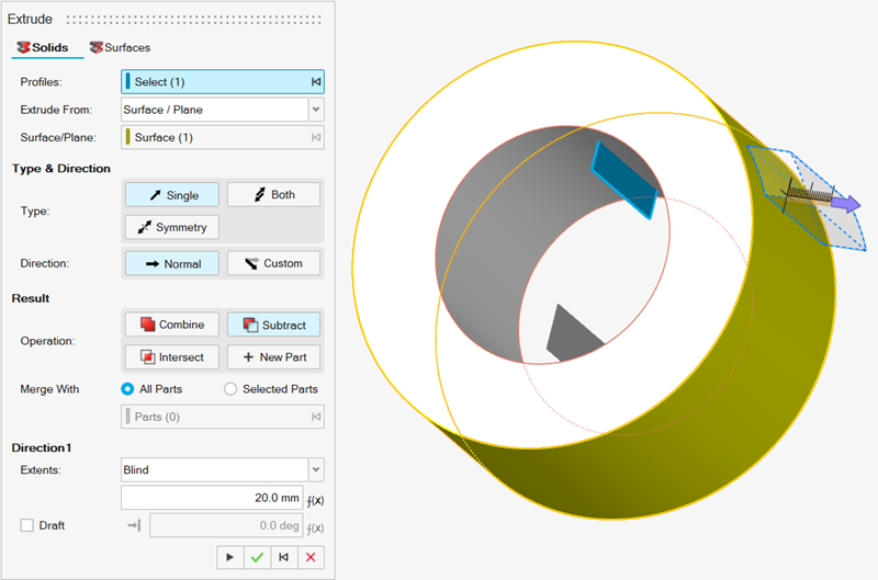

Extrude
Extrude profiles or 2D surfaces in one or two directions to create solids or 3D surfaces with optional end caps. Create a new part or combine, merge, subtract, or intersect the extruded shape with existing parts.
First, create the profiles and 2D surfaces that you'd like to extrude.
  1. To open the Extrude tool, do one of the following:
    • Press E.
    • On the Geometry ribbon, select the Extrude tool.
      Note: The tool may be hidden in the dropdown menu. To access the dropdown menu, you can do one of the following:
      • Select at the lower right corner of the currently displayed tool.
      • Click and hold the currently displayed tool.
    The guide panel appears.
  2. Choose the entity type that you'd like to create:
    • Solids: Extrude as solids.
    • Surfaces: Extrude as 3D surfaces with optional end caps.

  9. Adjust the extruded shape along Direction 1 or Direction 2:
    To Do this Notes
    Adjust the extrusion length Do one of the following:
    • In the microdialog, enter the Distance .
    • In the guide panel, for Extents, select Blind, and enter the Distance.
    To reverse the direction of the extruded shape, in the microdialog click Reverse Direction .
