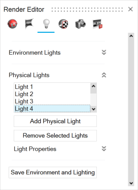

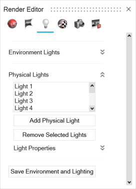

Add Physical Lights
Add point lights, which radiate light in all directions and are useful for generating soft shadows. Common examples include light bulbs and candles.
On the Rendering tab, select the
Editors tool.
Tip: To find and open a tool, press Ctrl+F. For more information, see Find and Search for Tools.The Render Editor appears.
Select the Environment Lights tab.
- Next to Environment Lights, click the chevron.
- Next to Physical Lights, click the chevron.
For each light you want to add, click the Add Physical
Light button.
The lights are added to the list.
To modify the lights:
To Do this Turn lights on or off in the final rendering Under Light Properties, enable the On switch. Disable the switch to turn the light off. Lights that are on are highlighted yellow in the modeling window.
Lights that are off are hidden.
Change the light type Under Light Properties, from the Type dropdown menu, Point is currently the only option available. Change the unit Under Light Properties, from the Unit dropdown menu, choose from the following: - Watts/LED
- Watts/Incadescent
- Lumens
The Power value is adjusted automatically.
Adjust the power Under Light Properties, enter the Power. Change the color of a light It is recommended to use subtle, light colors for better results. - Under Light Properties, do
one of the following:
- Next to Color, select preview image. By default, it is a white box.
, then click
Select a Color.
- Define the color of the light, then click
OK.
Reposition a light In the modeling window, drag an arrow to move the light along the x-, y-, or z-axis. Change the physical size of the light Under Light Properties, enter the Size. Remove a light - Select a light from the list.
- Click Remove Selected Lights.
Show a light in interactive rendering mode Under Light Properties, turn on Show/Hide. Hide a light in interactive rendering mode Under Light Properties, turn off Show/Hide. -
To save the environment and lighting parameters to use as a preset later, click
Save Environment and Lighting.
The Save Environment and Lighting window appears.
