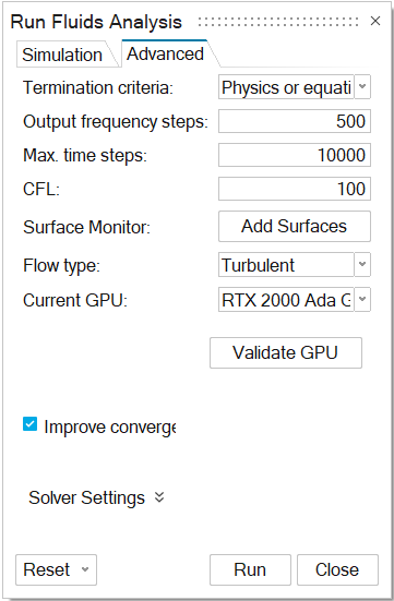

Using the Improve convergence option under advanced settings could benefit designs with long fluid paths or fine voxel meshes.
  1. Prepare your model for a Fluids analysis.
  2. Click the Custom Fluids Run satellite icon in the Analyze tool group.
    Tip: To find and open a tool, press Ctrl+F. For more information, see Find and Search for Tools.
    The Run Fluids Analysis window appears.
  3. Click the Advanced tab.
  4. Turn on Improve convergence.
  5. Rerun the simulation.
    Note:
    • The Improve Convergence checkbox is disabled when an implicit part is present in the model.
    • You can also improve convergence by decreasing the number in the CFL field and increasing the number in the Max time steps field.
