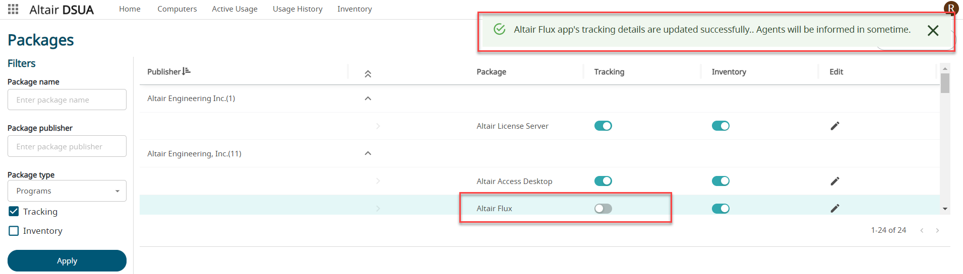

Toggle the button in the Tracking column to disable the
tracking of the package.
For example, to disable tracking the Altair Flux package, toggle the button of Tracking column of the Altair Flux package.
Figure 4. Disable Tracking
Message will be displayed at the top of the screen informing the DSUA agent will be notified not to track this package across the computers. -

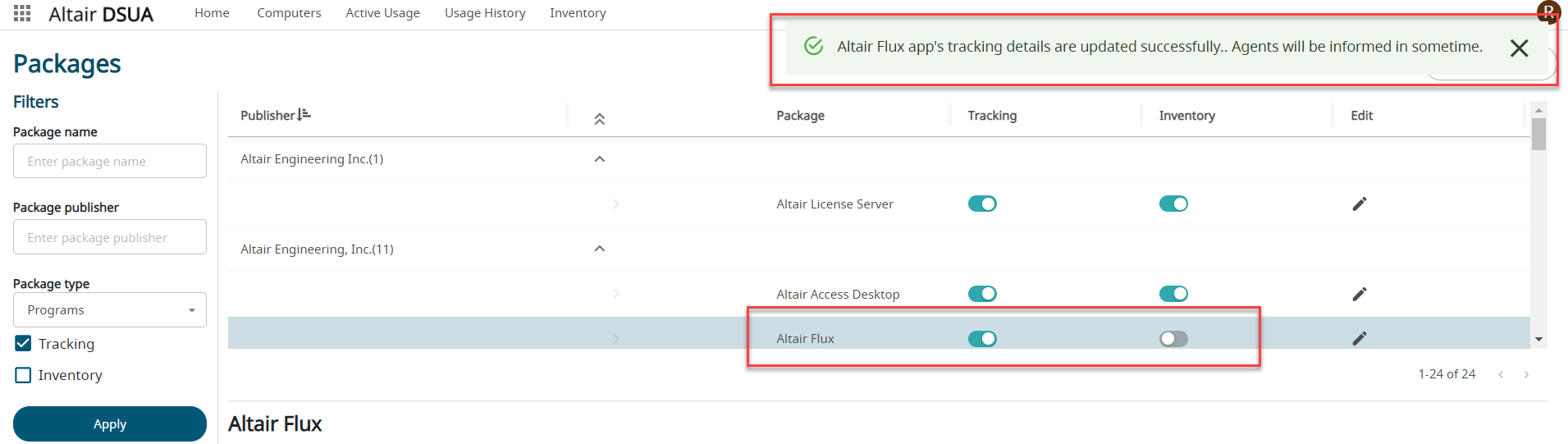

Toggle the button in the Inventory column to disable the
package inventory.
Figure 5. Disable Inventory

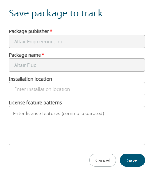

Save Package to Track window is displayed.Figure 7. Save Package to Track
- Update the Installation location.
- Click Save.

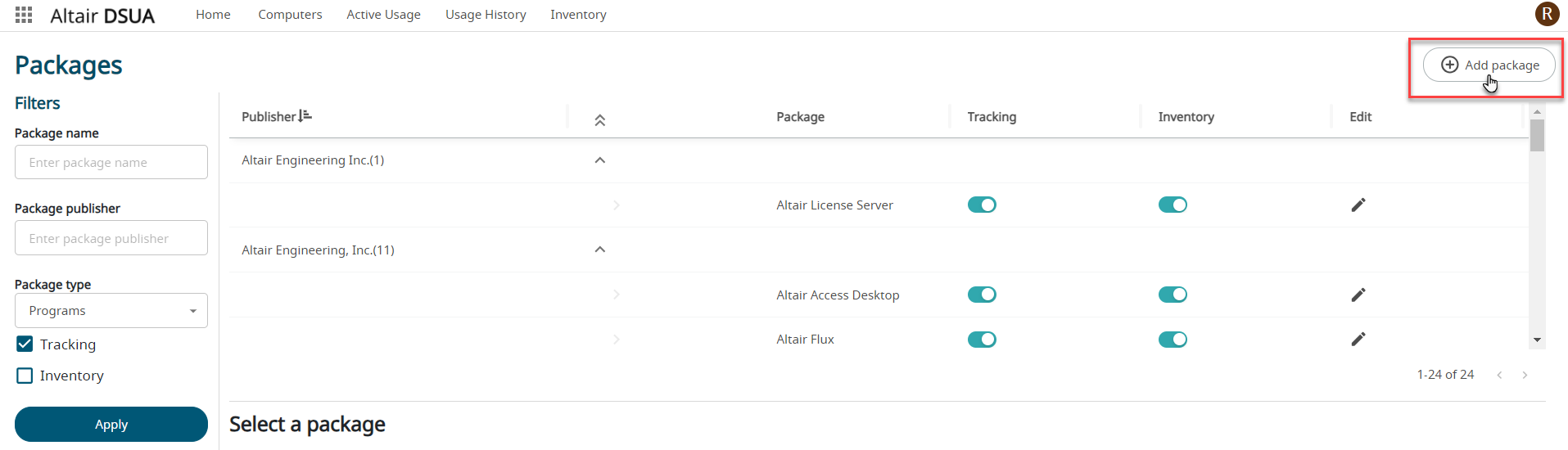

Click Add Package.
Figure 8. Add Package

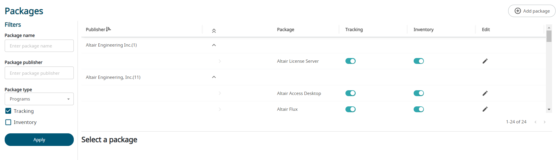

Add Package to Track screen is displayed.Figure 9. Add Package
Enter the following details:
- Package Publisher
- Package Name
- Installation Location
Click Save.
The package will be added to the list. By default, the added package will be tracked and inventoried.Refer to Disable Package Tracking and Inventory and Edit the Package Location for more information.
