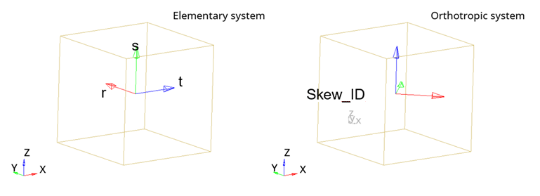

- Orthotropy direction
for 3D solid elements:
Table 1. IP Value Orthotropic Direction IP =0 Orthotropic directions are from the skew_ID directions. If skew_ID is not defined, global coordinate system is used.
IP =1 The elementary direction t defines the third orthotropic direction. The first and second orthotropic directions are rotated by orthotropic angle in the plane (r,s).
IP =2 The elementary direction r defines the third orthotropic direction. The first and second orthotropic directions are rotated by orthotropic angle in the plane (s,t).
IP =3 The elementary direction s defines the third orthotropic direction. The first and second orthotropic directions are rotated by orthotropic angle in the plane (t,r).

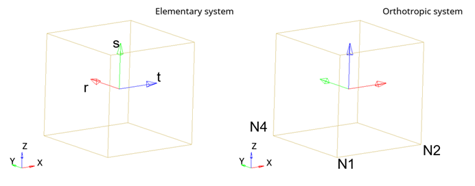

IP =20 Orthotropic directions are from element connectivity (N1, N2, N4).

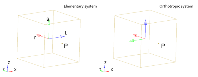

IP =21 First orthotropic direction is defined from point P and the center of the element. Second orthotropic direction is defined from global Z and the first orthotropic direction.

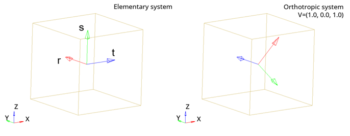

IP =23 Second orthotropic direction is defined from vector V. First orthotropic direction is defined from the second elementary direction and the second orthotropic direction.

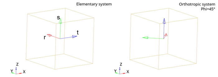

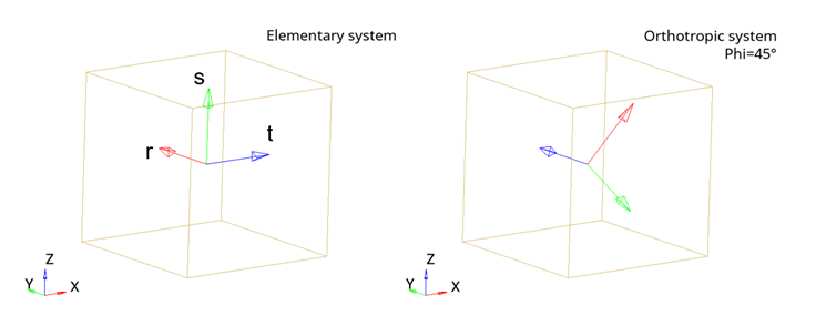

First and second orthotropic directions are rotated by orthotropic angle .
