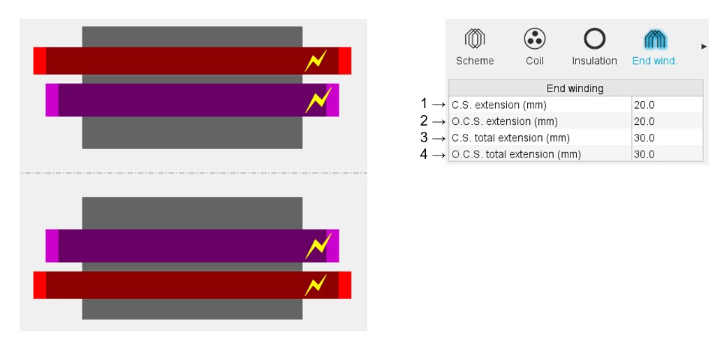

End winding
Note: Compared to the 3-Phase Winding, the only difference in
the insulation section is that for pole DC winding, there is only one type of
end winding, which is the U-shape end winding. Please refer to the user help
guide: “Windings” for further technical details about the topology of end
winding and its dimensions.
| 1 | Definition of the connection side straight extension |
| 2 | Definition of the opposite connection straight extension |
| 3 | Definition of the connection side total extension |
| 4 | Definition of the opposite connection side total extension |
